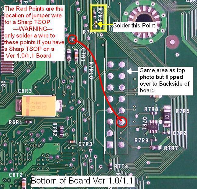

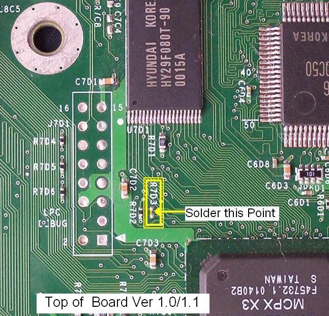

what motherboard version do you have why is r7d3 connected ??
why solder on the bottom of the board ? u only need to connect the jtag to the point above tha cap wich you did
chek the soldering if there is a connection , no need to connect anything at the bottom of the motherboard
r7r3 need to be bridge ,after that just reconnect the original hdd en disc drive put in the autoinstaller i should work

its a 1.1 with sharp and i didnt even come to the point of flashing after i soldered both connections and jumper wire the xbox wouldnt output any video signal and disc drive made a weird clicking noise
i followed the how to on https://consolemods.org/wiki/Xbox:TSOP_Flashing
r7d3 was bridged on top and bottom since that what the how to told me + the jumper cable was needed only for sharp models

tried it with only r7r3 but again no video signal

so i tried it like the video says with only the jumper cable but again no video signal and weird disc drive clicking
after desoldering the jumper cable i get video signal again and no clicking sound
