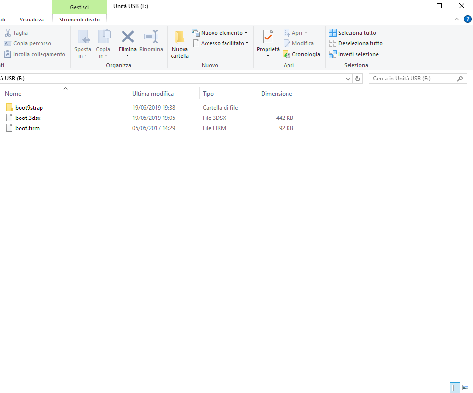

Hi everyone, I have now bought an old 3ds xl and I want to install the CFW, I want to use ntrboothax and I'm using a R4 gold plus r4ids.cn but when I go to put the magnet and make the combination and turn on, the 3ds stays on the screen black and with the blue led, how do I fix?

Files.

That is your 3DS SD card and not your R4 one correct? The files need to go on the 3DS SD card.
Edit: Also the card needs to be FAT32 formatted.

Sometimes it happens that it turns off, sometimes it freezes, when I had my old 3ds, ntrboothax worked perfectly so I know how it works and I'm using that guide.
P.S: When I start 3ds normally, the message appears that I removed the SD, I press A and reappears, I press a and it reappears indefinitely.
P.S 2: it is SD problem.
