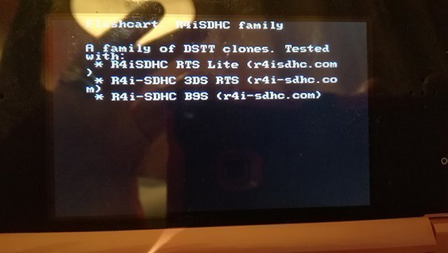

A friend is trying to do this with her R4i SDHC Dual Core 2015; She got it to the point in the guide where you press continue after selecting her card and RETAIL, and this screen is where the process hung up:
She's following the guide and using the dsi version as stated. Any constructive advice would be appreciated, as I don't have this myself to work on. Also, for firmware restoration, anyone got a clean backup for that card? I don't know if she does, unfortunately.

I don't get what seems to be the issue? All I got from your post is "the process hung up". What does that mean?
Sorry, it means it sat with that on the screen for about 15 minutes with no feedback, and no exit prompt, nothing she can select. I'm having to assume that's not normal, which is why I asked.
She followed the guide, so launched "ds_ntrboot_flasher_dsi.nds", pressed A, Selected her card, pressed a, pressed a to inject, chose RETAIL, pressed a, and there you go.
If you need more information I can ask, but I need to know what you need to know, i guess.
it means it sat with that on the screen for about 15 minutes with no feedback, and no exit prompt, nothing she can select. I'm having to assume that's not normal, which is why I asked. She followed the guide, so launched "ds_ntrboot_flasher_dsi.nds", pressed A, Selected her card, pressed a, pressed a to inject, chose RETAIL, pressed a, and there you go. If you need more information I can ask, but I need to know what you need to know, i guess.
Is this a r4isdhc.com flashcart or a r4isdhc.com.cn/r4isdhc.hk flashcart?
