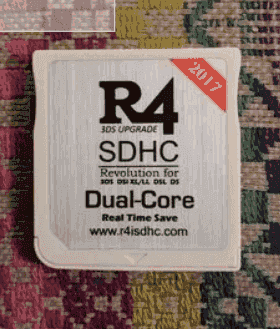

I am using an R4 DHC Gold Pro it says www.r4ishdc.com and has a 2017 in the top right corner. It keeps saying "Flashcart setup failed" when I try to do the ntr.

I did exactly as you said...and used the R4 option instead of R4 Gold and it worked perfectly. The card says it is gold pro...but the gold pro option failed everytime.

Those are unsupported by ntrboot. Perhaps a flasher will be available in 2-3 weeks. But as it is right now, they are unsupported.
so is the dual core from "r4isdhc. com" supported or are there still some issues with it? thanks in advance
