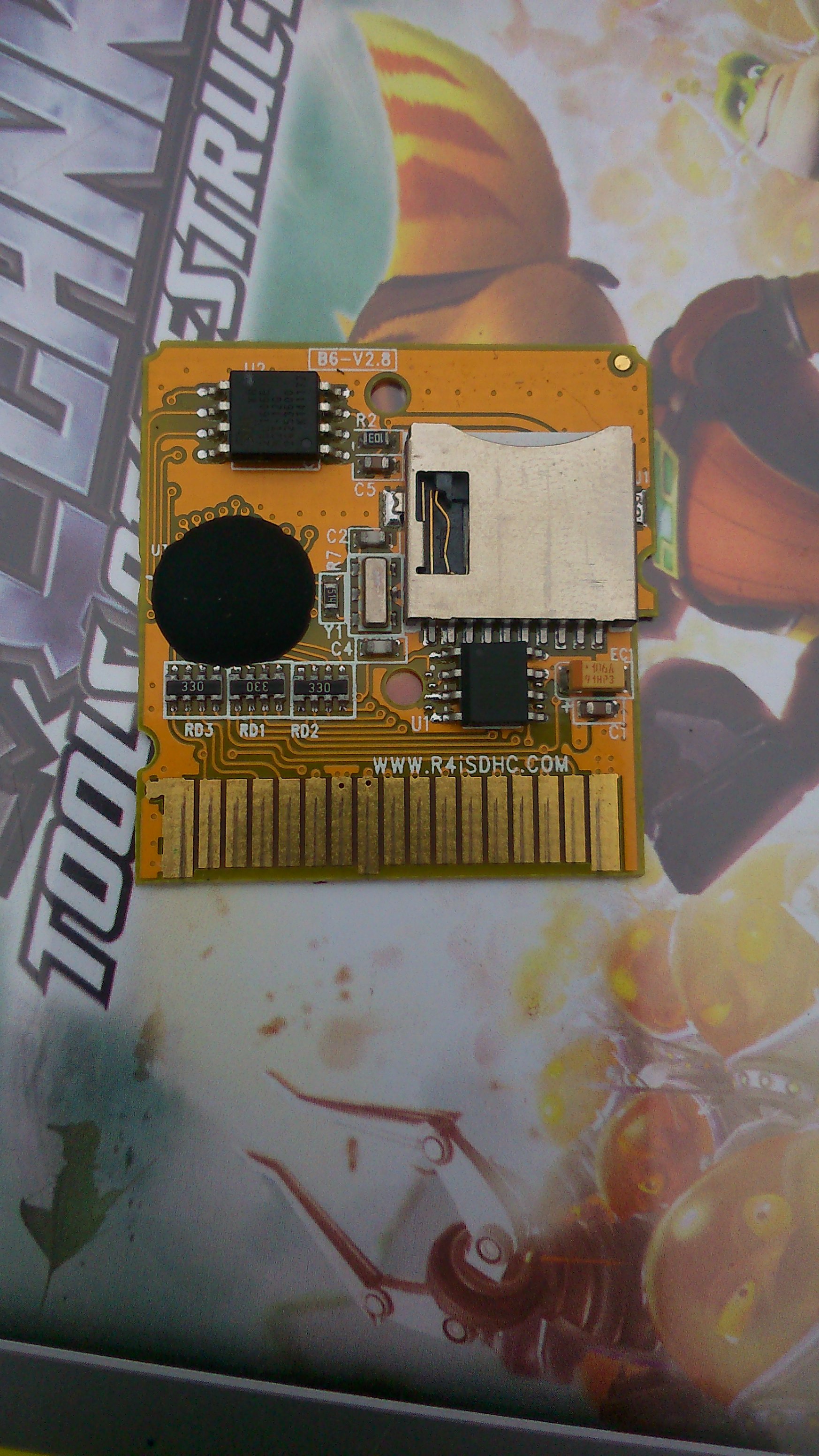

These are insides of my R4 SDHC Dualcore. If NTRBootHax will be released would it work?
