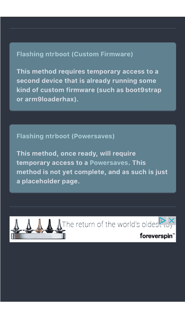

Is there / will there be any way of flashing ntrboot to my flashcard without access to a another hacked 3DS?
This prerequisite makes it basically impossible for me to get boot9strap onto my 2DS, because I don't know anyone owning a hacked 3DS, heck, I barely know anyone owning a 3DS at all!
So, any help will be highly appreciated.
If it you have an Ak2i you can use an original ds system (phat or lite) to flash it. Dsi won't work and neither will 3ds.
