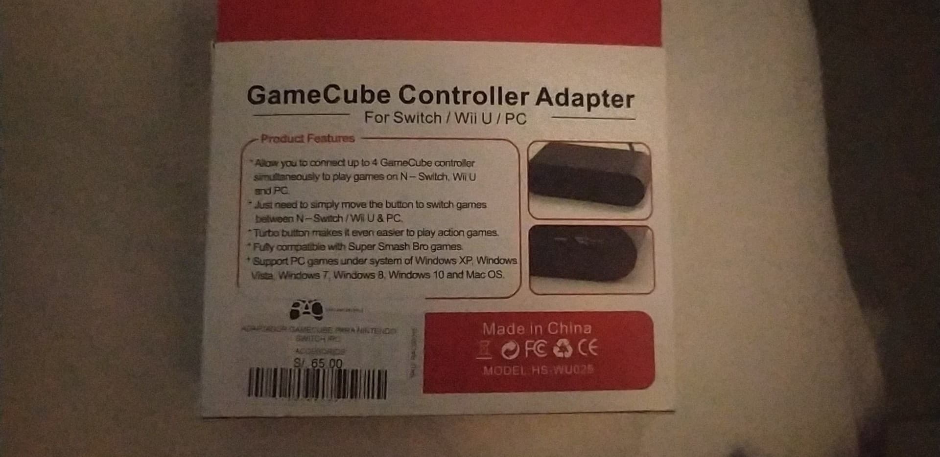

I have this problem with a Wii U GameCube Controller Adapter clone, i connect the original gamecube controller to this adapter but it doen't recognice it.
Is there any config i need to use or something?

Make sure the device is switched to Wii U and not PC as those have a switch.

Thanks for the reply, it is swtiched to WiiU/Swtich i'm attaching photos
Then likely it's not compatible until someone makes a controller.ini for it. Get HIDTest for Wii and see if it detects it there.
The only 2 adapters that work out of the box are the official Nintendo one and the one made by Mayflash.

Ok, thanks, is there any tutorial on how to do it?
