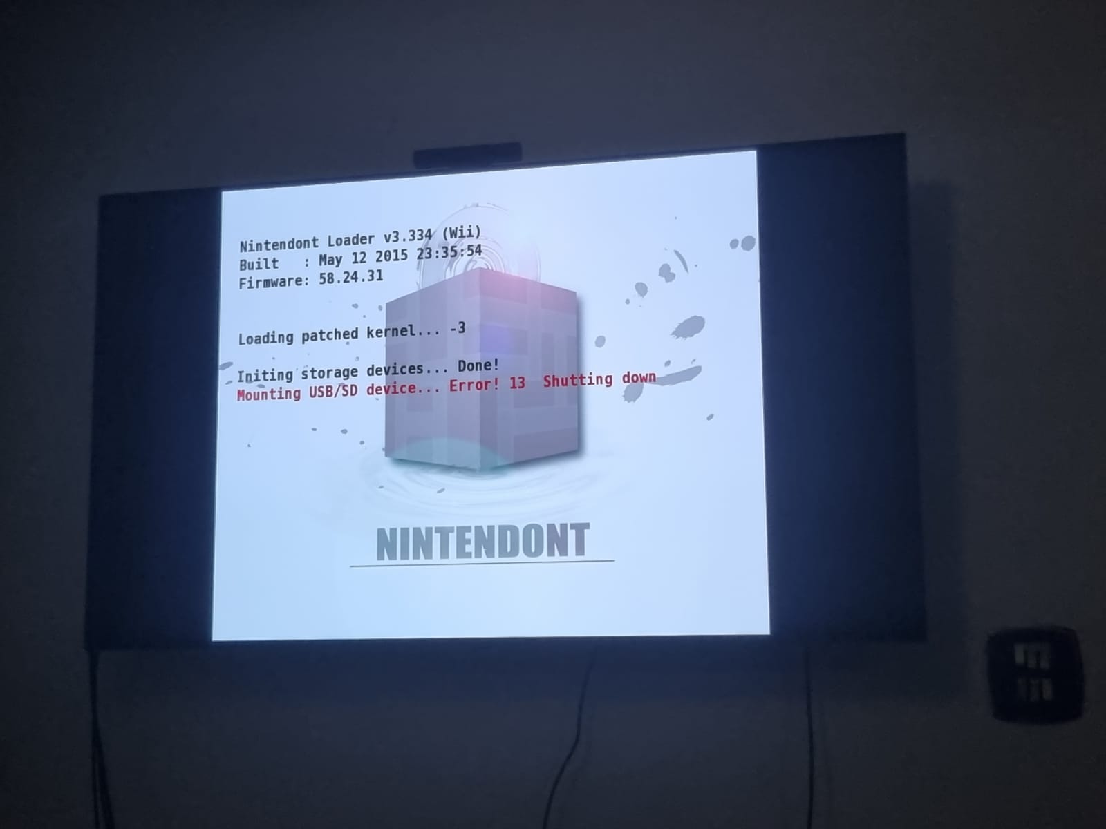

Hey guys, how are you?
I unlocked my Wii and am trying to use Nitendont. In the process I did, I used:
base IOS 57 - slot 249 - revision 65535
base IOS 56 - slot 245 - revision 65535
base IOS 58 - slot 251 - revision 65535
I'm using a 500gb partitioned hard drive where half is WBFS for Wii games and the other half is FAT32 for Cube games.

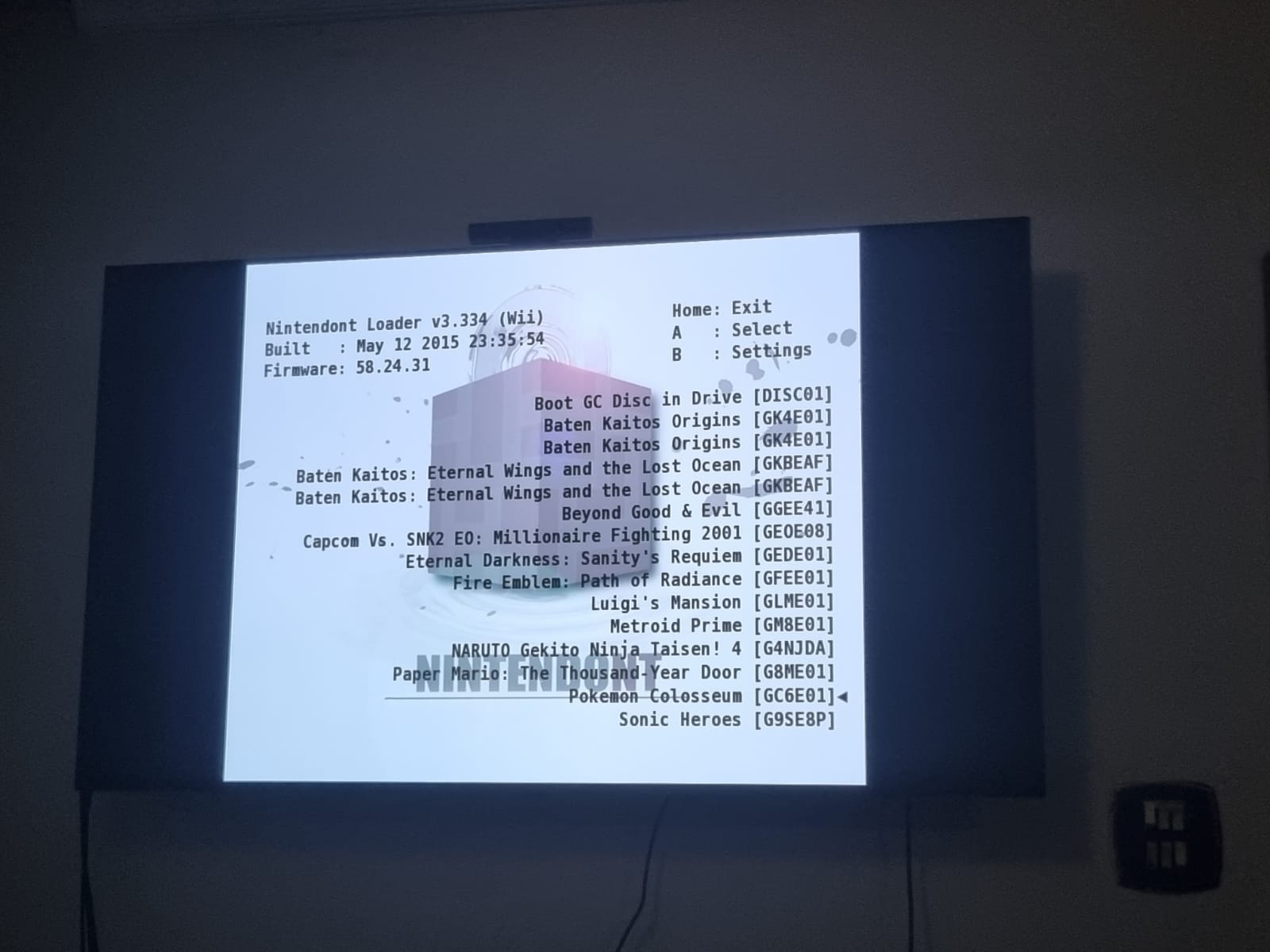

As you can see in the screenshot, the games are listed normally on Nintendont (On USBLoaderGX I even downloaded the images) but when I try to run, the error screen appears.
Solved, the problem was that the HD partition where the Cube games were, was like logic, I changed it to primary and everything worked.
