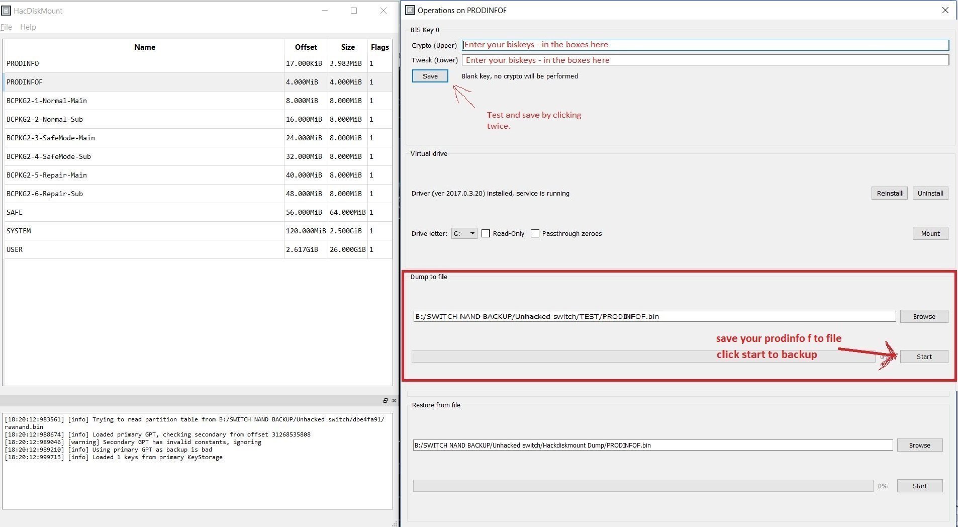

what do you mean you failed to finish with hacdiskmount thats your problem right there,, thats direct access to the nand,,
with hackdiskmount you need to backup your prodinfo and prodinfo F
first
follow this guide to backup what you have.. > CLICK
Skip the part that mentions to run cfw and kezplez as you cant boot the console anyway..
Once you have the rawnand.bin and boot 0 boot 1 save them to your pc...
Secondly
Connect you switch to your pc with hackdiskmount by using the memloader payload and selecting emmc.ini on your switch then Run hackdiskmount as administartor and the goto file and select pyhsical drive and select the the linux ums drive then ....
you need to open prodinfo enter your biskeys test and save and click on dump to file
and do the same for prodinfoF enter your biskeys and click on dump to file
MAKE SURE NOT TO OVERWRITE THE OTHER OR RENAME THEM

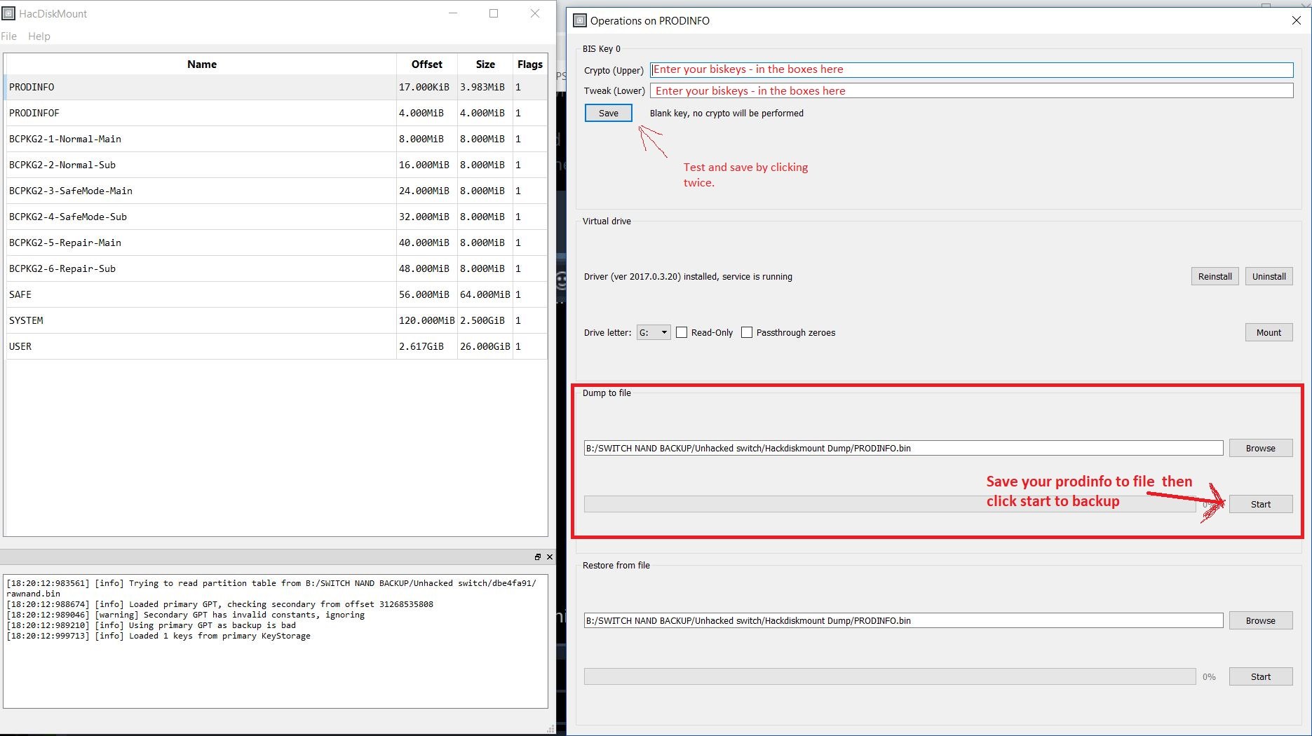

first
Secondly
you need to open prodinfo enter your biskeys and click on dump to file

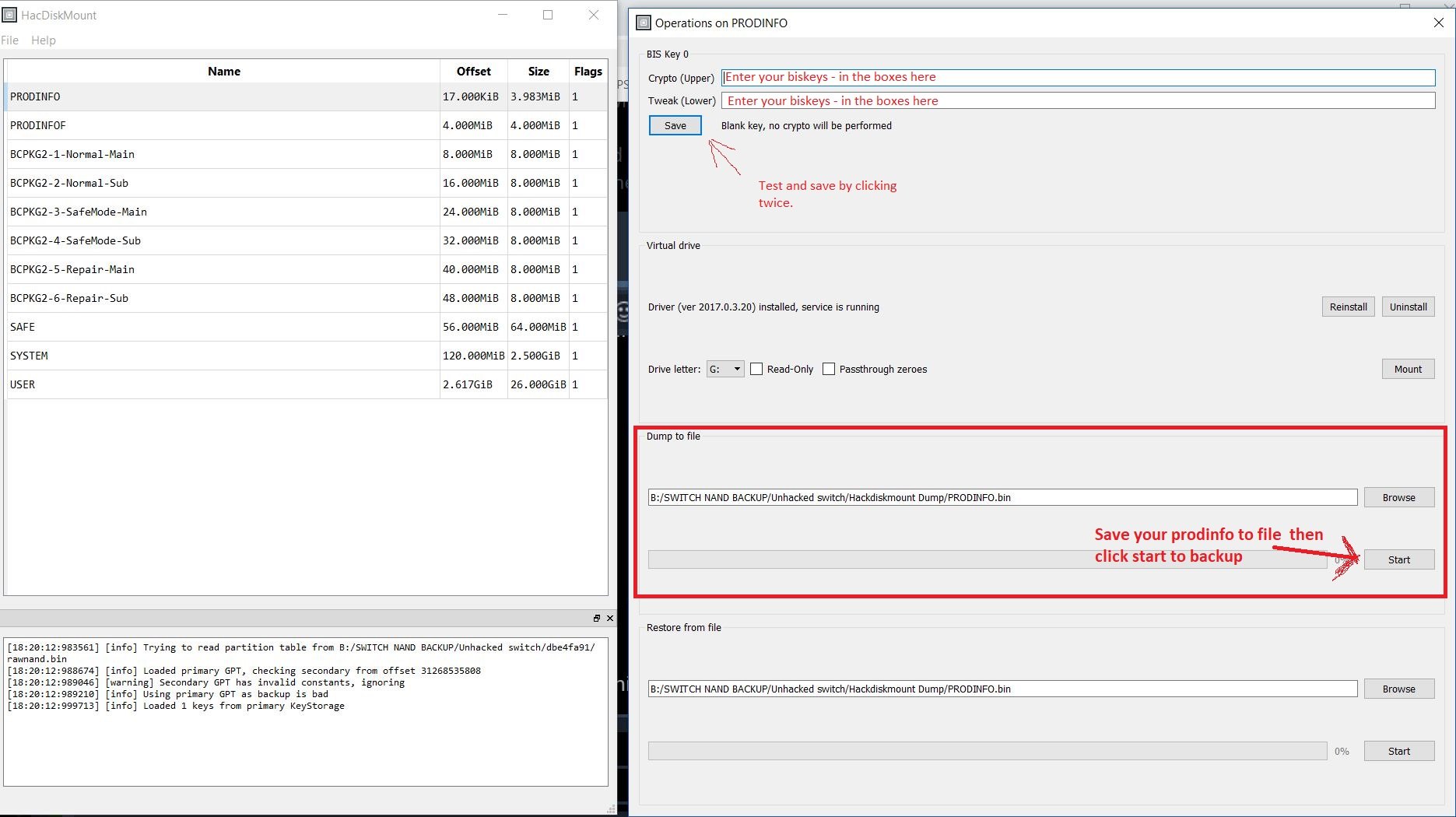

first
Secondly
