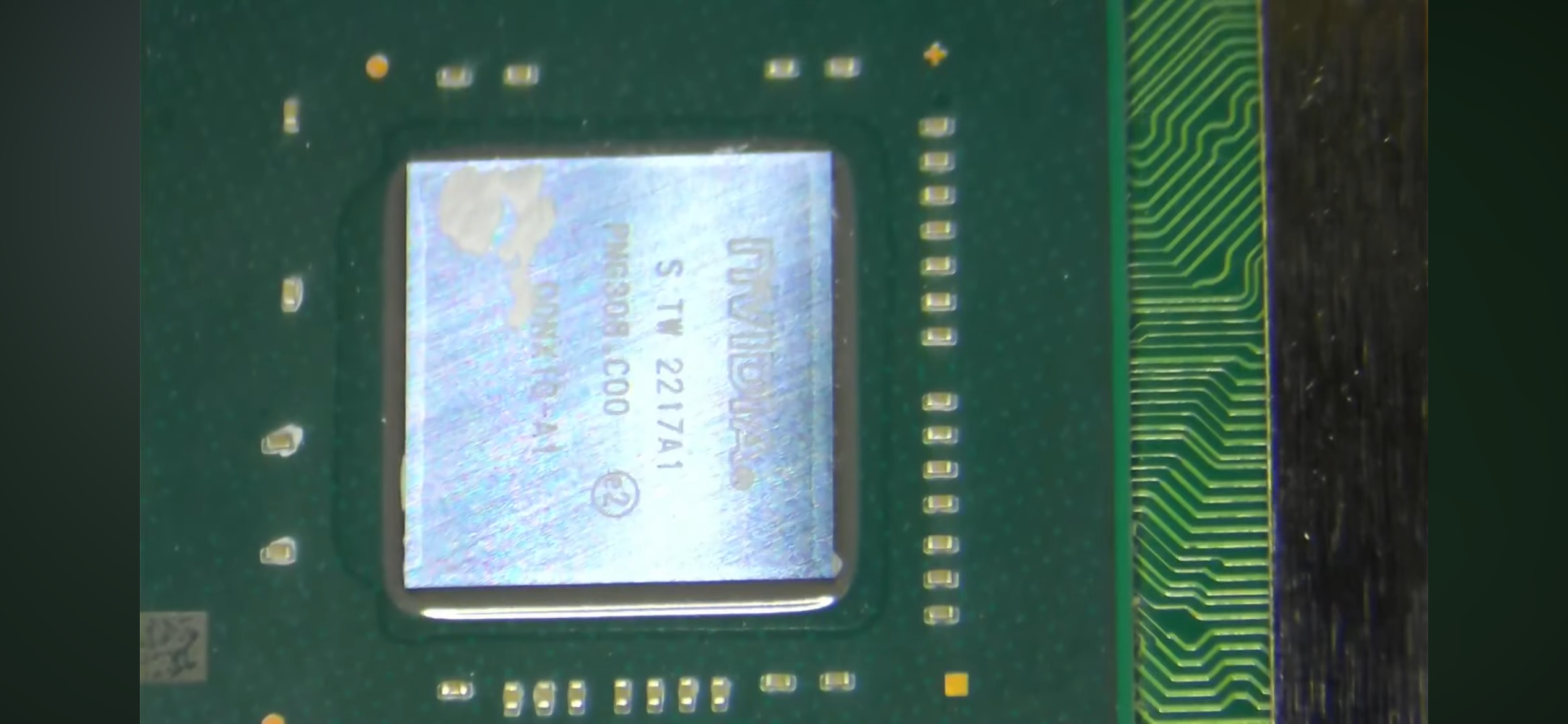

Good morning, I need the values of these capacitor friends. please I would appreciate it very much
Apparently they are all the same :
ceramic capacitor 1uf 20% (0201 packaging/size)
https://gbatemp.net/threads/what-is-the-capacitor-value-on-top-of-nintendo-switch-apu.572089/
Is every single cap on top of the APU the same 1uf spec? I keep seeing some people mention some being 0.1uf and I had some lost during a reball so I want to make sure I replace them with the correct spec before I call the repair finished on it. Reball was successful and works without the caps but want to have the power management stability of having them plus one was the sp1 cap and I will be installing a picofly to the board as well.
Yes evry cap on the apu itself is 1uF, however next to the apu on the motherboard is .1 uF cappacitors
