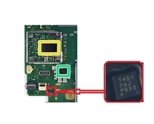

I've got an oled with the same issue. Doesn't display temperature and same behavior when booting. No clue as to what's wrong.
However on mine the battery page does show information but the status won't change from "not charging" when a charger is connected.
Afaik, the voltage and battery temperature readings come from the M92T36 power management ic.
It is connected via I2C to the cpu.
If you knock off one of the pull up resistors then the data communication will be broken and Helate and the OFW won't have any idea what is going on.
Those resistors are next to the shielding of the CPU so they are easily damaged when trying to remove the shield.
If you have valid voltage readings but no battery temperature readings, then maybe something is wrong with the battery or the connector.
The Switch battery most likely has a thermistor to monitor the temperature.
If something is wrong with the battery, the OFW will refuse to boot afaik.
There is another temperature sensor on board : T451
Maybe look for some damage in that area.
Managed to revive mine by heating the max17050 chip area with hot air and flux. Shows cpu temp in Hekate now and boots properly.
