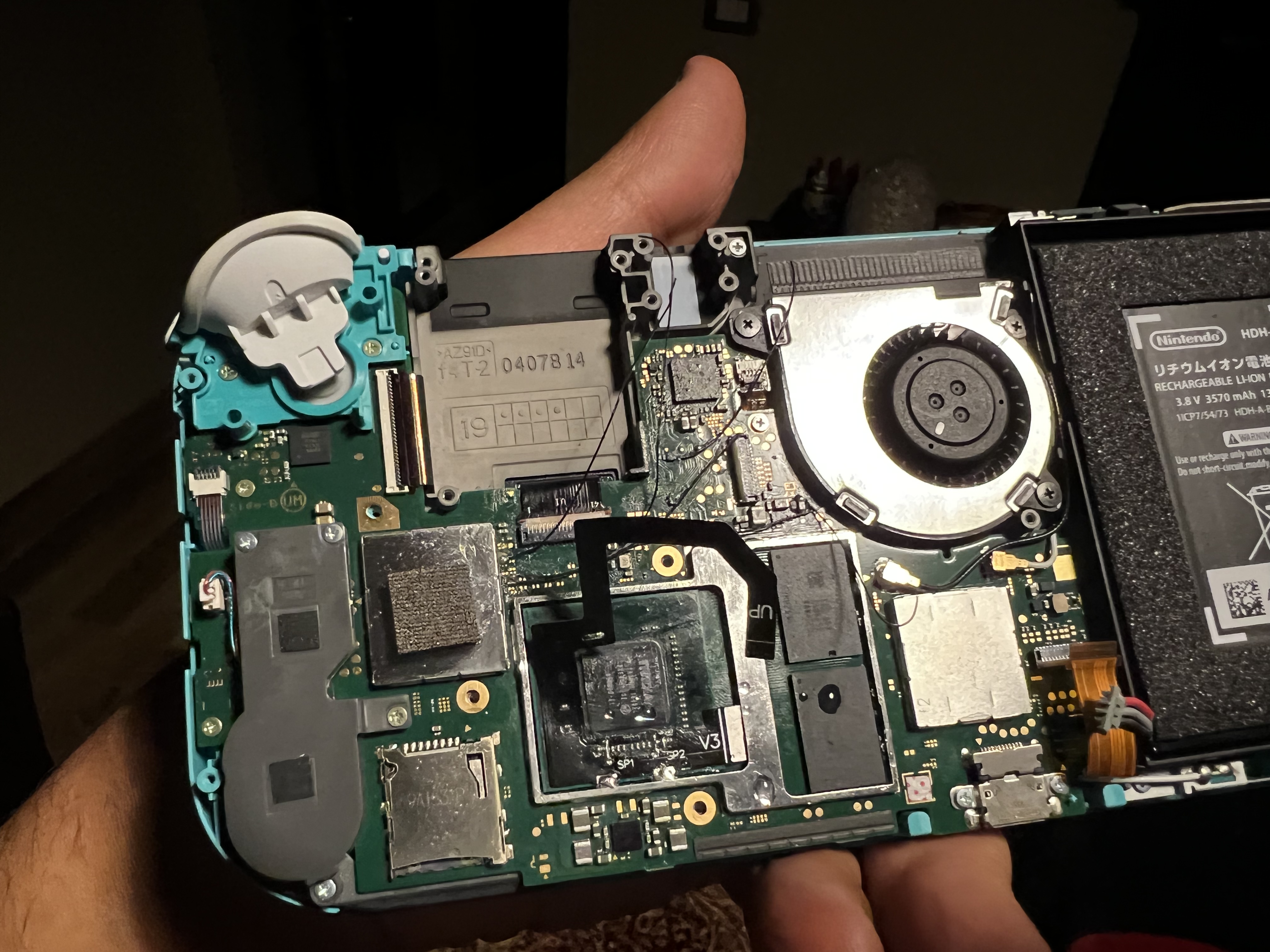

Hello guys,
I will try and wrap up as much as i can. I did several switch installs with lites as well. Had an oled Hwfly chip Oled version and did the install.
It glitched and got the no sd screen, tried a couple of time and installed a card to boot heakte and found the screen flickers so i shut it off and uninstalled everything fearing of a short.
Booted the console to stock and backlight is on but black screen and no sounds which means it might be briked or something.
If someone can guide me where to start, as i need to turn this bad boy back again id appretiate it.
I attached the points where i soldered and desoldered for refrence.
I dont have a clear one for the soldered points.
Any help is appretiated.
Update i found short to gnd on these 3 caps if that helps marked in yellow.

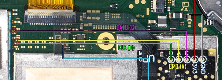

Those vertical ones are not caps, they are coils (not sure if the name is correct in english, sorry) they are made to short, are you sure about the horizontal one ? because that's a cap
Without the mochip you get this back light on and black screen ok, but is this after just taking the chip out or even removing the wires & the cpu qsb ?
I installed this chip on lite and to be honest after turning it on, it didn't boot and froze on green light, so i took the chip out and i was very surprised the switch would not boot screen turned on but black screen like you, i removed EVERYTHING and then the switch worked again fine, did all the installation again and then everything worked fine
What i remember is that on first install is i shorted all those double points together
Normaly this is not a problem but when i did everything back the second time i soldered only on the point of the diagram and everything worked
