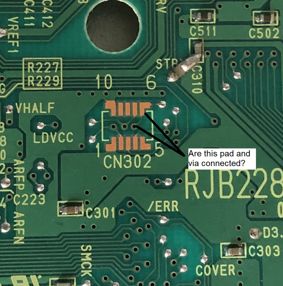

Im attempting to install a xenogc on my dol-001 pal.
Ive tried the direct install but the chip kept giving the red light so i went for the wired one. Still red led, sigh.
This is the second attempt, I'm using some alt points but im started to thinking the modchip is faulty (?)
Thanks ❤

Red light = faulty install. Usually nothing wrong with the chip mate. Your alternative soldier points look a bit funky, too. Better stick the the ones suggested from manufacturer.
Except fot the power and the gnd ( bottom left pin, ive lifter it up while desoldering the chip from the direct install; the 5v is taked out from that little smd ) everything is soldered following the schematics.
It's hard to tell and it could just be the photo, but it looks like the connection between one of the pads and the via that goes to the control MCU might be broken. I've attached a photo of the place I'm talking about:
It's hard to tell and it could just be the photo, but it looks like the connection between one of the pads and the via that goes to the control MCU might be broken. I've attached a photo of the place I'm talking about:View attachment 313207
Yep, the via starting from the central hole to the top right pad are connected. Im sure because ive cleaned all the pads multiple times and, except for the pad 1, its all good!
