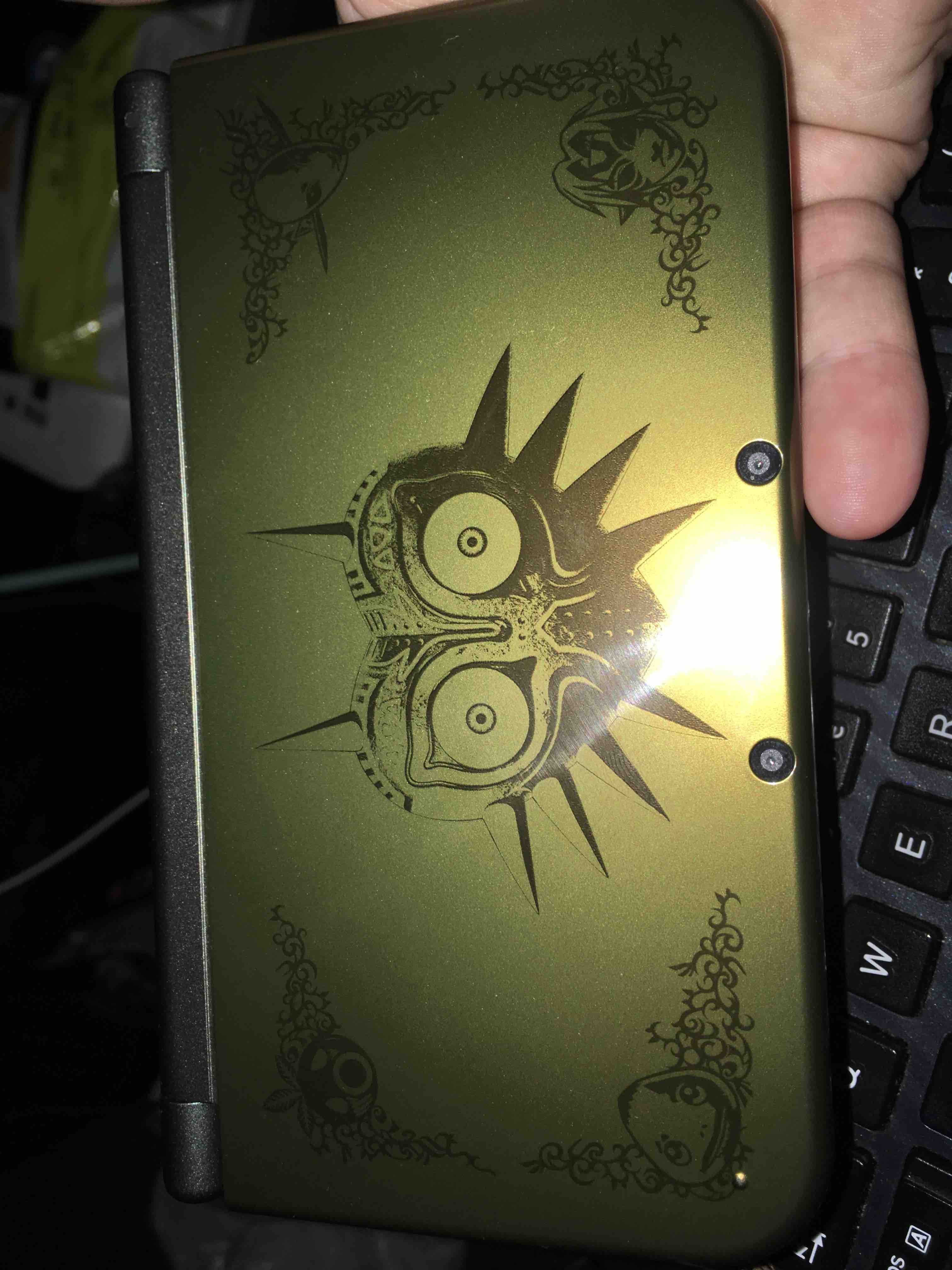

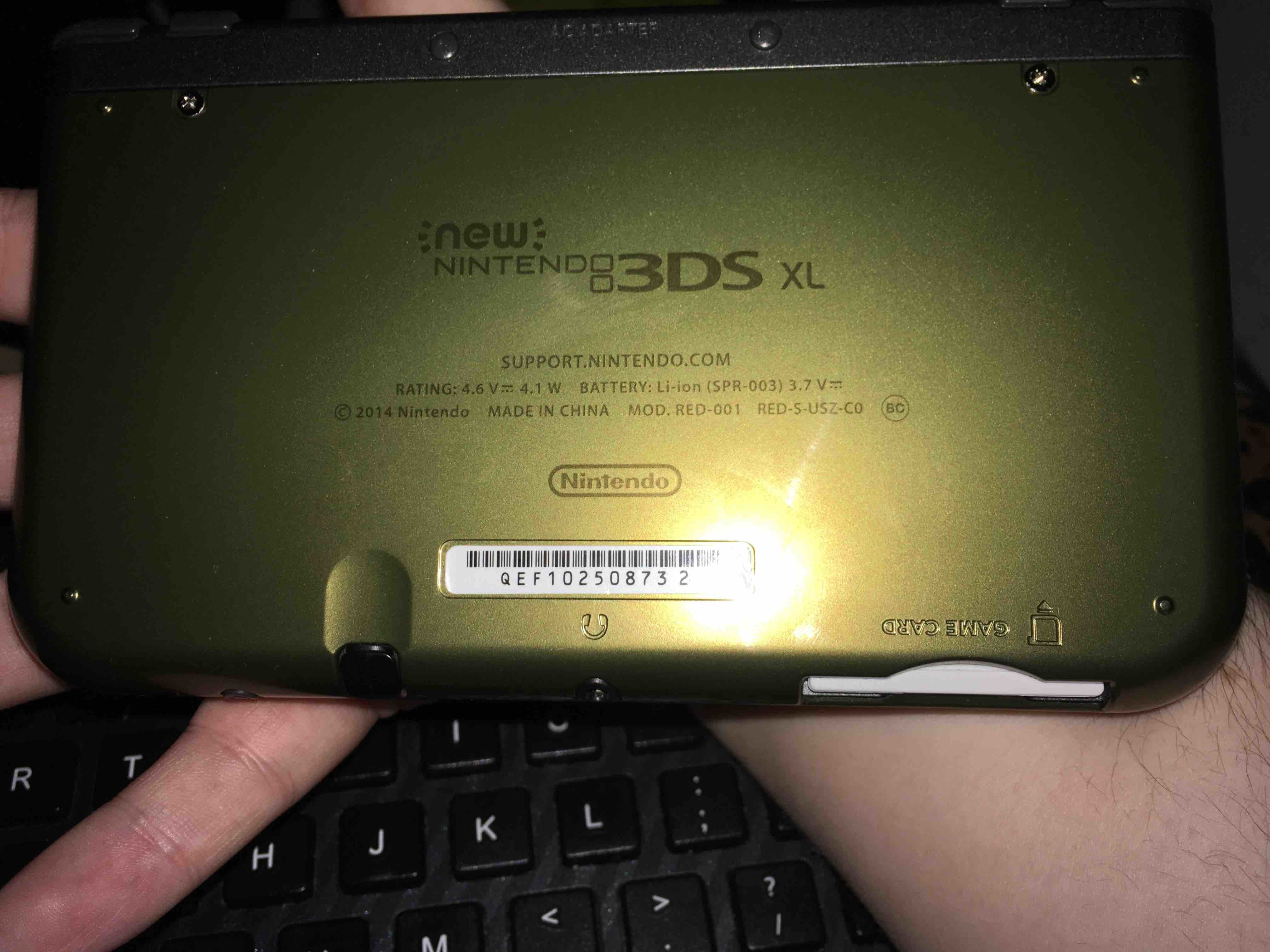

I bought a grey N3ds XL and I basically swapped it to the Majora's Mask shell, I had a lot of trouble with it though.
Basically once I took the 3ds screw covers off (I just screwed through the rubber as I couldn't take them out, ended up with a big scratch trying to do so) the back of the topscreen was pretty easy to get off using some guitar picks but trying to oget the replacement one on just wasn't having it, there are 4 pieces of plastic on this underside of the replacement case that were supposed to fit snug into these slots, but they bent out of shape trying to pry it on while it was going on at one side it was popping off at the other, so I dremelled them off and got it on that way.

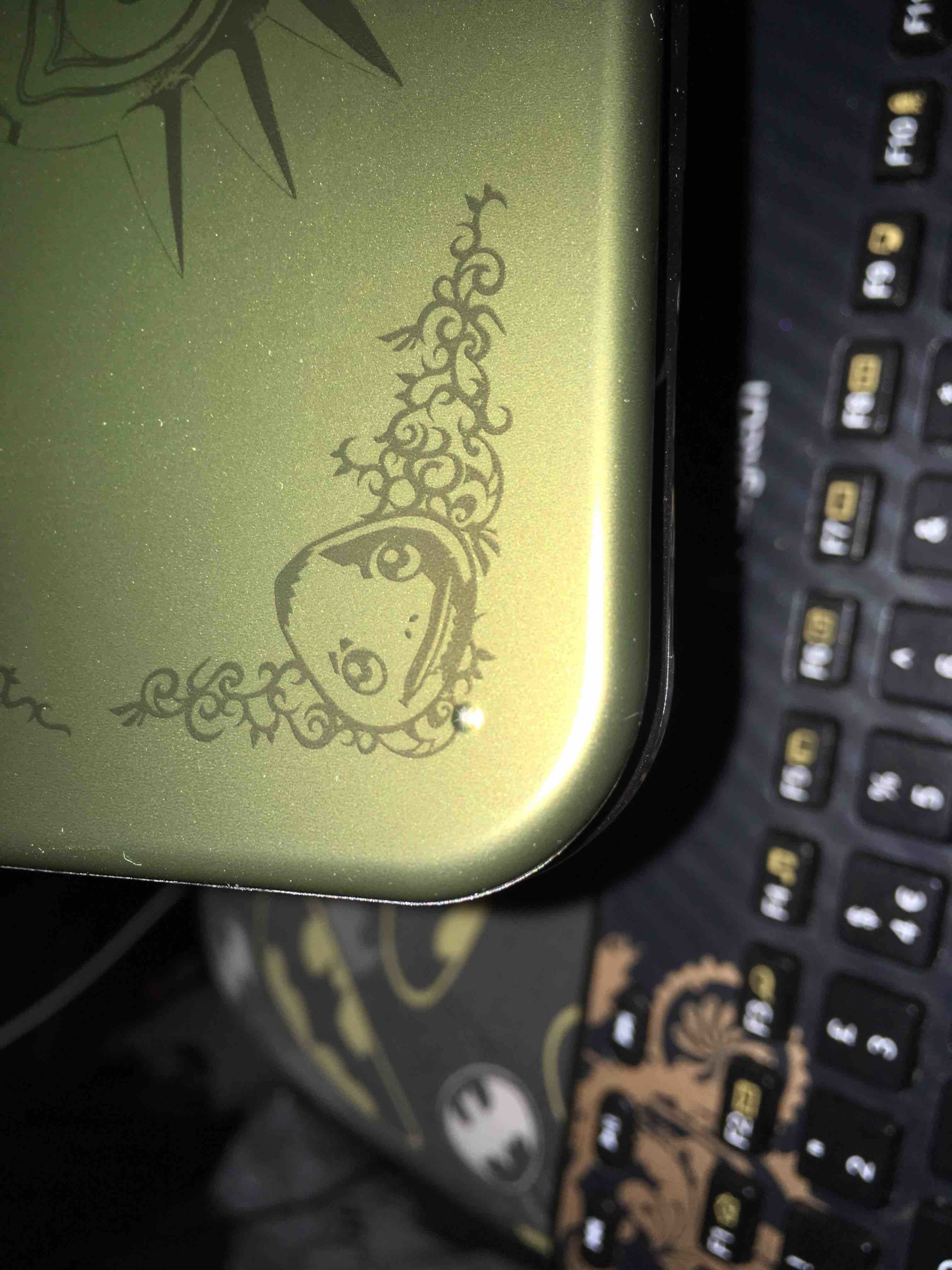

But it looks nice! apart from this where I used the wrong screw and screwed it too far it nearly came out the top shell
