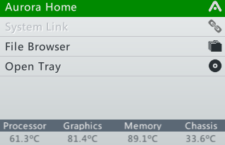

Are these temps bad?
Also, when I used FSD3 and saw the 'Auto' fan setting on the right side of the setting I thought that meant going to the right with the slider would set it to it Auto. Instead, it sets my fan at the lowest setting, and after moving the slider just a little bit back and forth my Memory temp jumped up to to 95c and I shut the console off.
That is a bad design flaw in FSD3 that need to be changed as well as a confirm option before actually applying the fan speed change instantly.

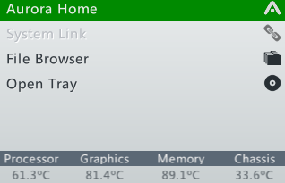

https://www.ncesc.com/gaming-pedia/what-is-the-normal-temperature-for-xbox-360/
Yea should leave on auto. It will run faster when it heats up to cool itself down, as intended.

Yea, nothing should be higher than 75° at the most.

Use Dashlaunch to adjust the fan speed. Since we're still in the winter, having it set to like 40% should be ideal, you can take it to 45% if you want, and it should get louder sp at 50% and up (only use the latter in the summer months).
I personally don't like setting it to auto, i like to control the temps with nothing higher than 65°C even in intense in-game moments..

I should probably mention mine was manufactured in May 2008 so it is a Falcon v3. And for quite a long time now it has been loud for years.
And speaking of dashlaunch, I would rather stay away from that. If I accidentally installed it my system would be bricked.

Temps seem average on my Trinity. Best to set it to "Auto", don't tinker with anything else as you can risk damaging the console.
