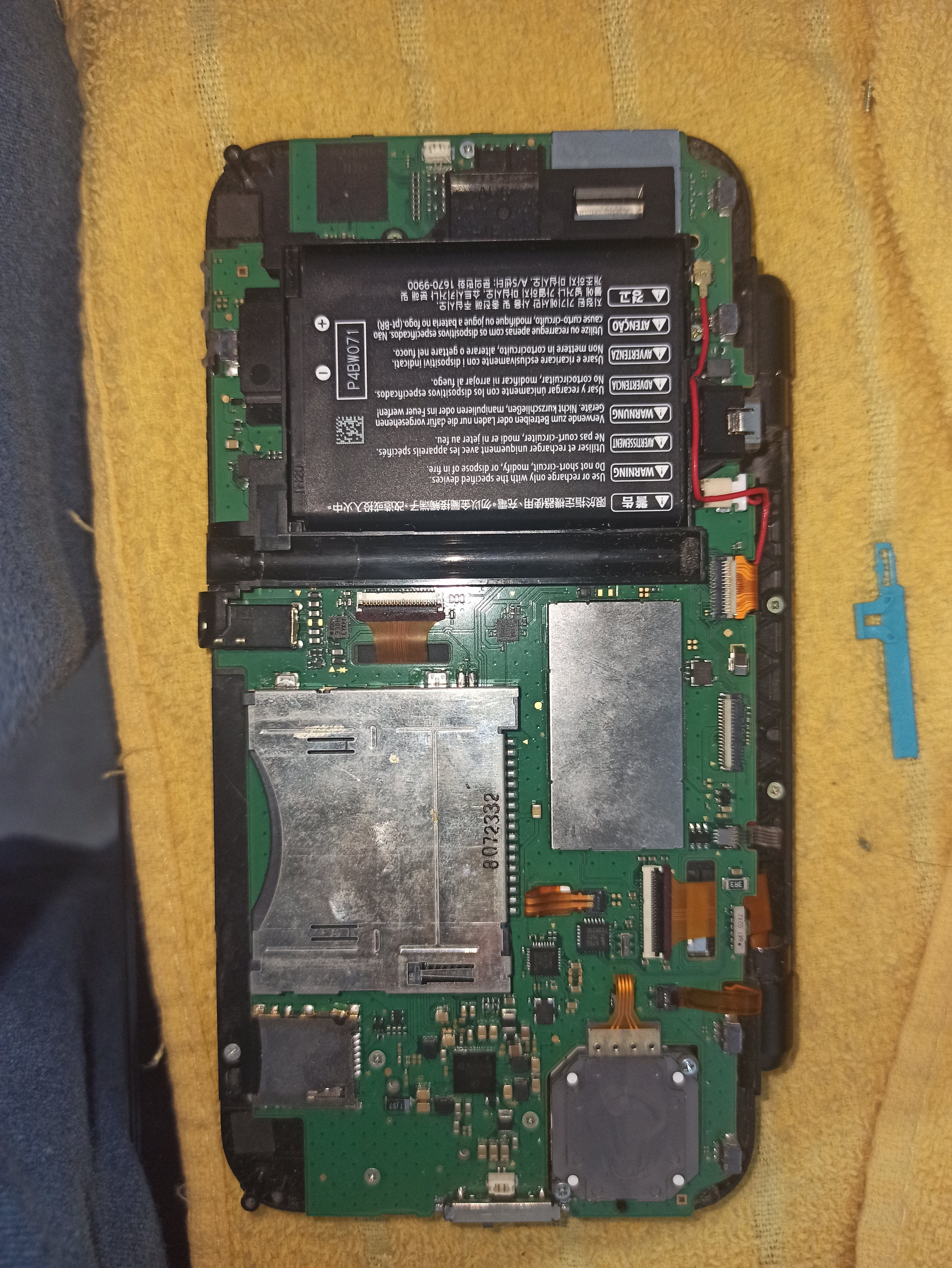

It shows the charging icon and here is a picture of the battery

Are you referring to the red cable? It looks fine to me.

Maybe is something internal, I got a multimeter but I don't know what to analize, here are two pictures of the motherboard.-
Align to the - and + to try the multimeter for the battery, just use the + and - and for internal you use upper and downer silver thing ( you can align the battery to know exactly)
Sounds to me like the fuse for charging/battery is blown. Check continuity for every component on the board with "FX" marking where X is a number.
