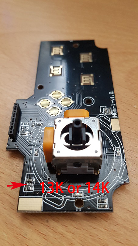

The replacement of 10k with 5k did not work for the international version. Finally I figured out that it is the same as the Japanese version. Only the 10k controlling the left direction should be replaced with 14k. I also uploaded a video on bilibili.

Can you show a pic of the correct one to replace?
@jidatui or anyone else, the pcb on the international version has a lot more resistors than the japanese so can you indicate which is the correct one to replace for just left movement?

I created an account just to thank Jidatui. His fix worked for both my International and Japanese Neo Geo Minis! I have different images on them and both got the left joystick blues after the hack.
I used a 13k ohm resistor bought at Amazon. If you're new to soldering, please watch some SMD soldering tutorials before proceeding. I did not remove the existing solder after removing the original resistor. I just heated it up a bit, pulled it out with tweezers and then installed the new resistor using the existing solder
