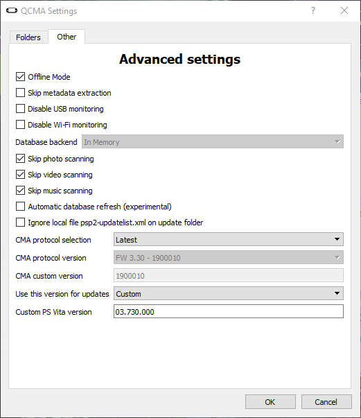

Well i changed it there.After i had changed it for the update it was 03.730.000 and on top of it i have changed it to custom.
Here are my settings.As i said-i want to downgrade to 3.65 from 3.73 or 3.72.

you are changing that 3.73 number to 3.65 right?
I believe thats the firmware your going to not the one your on currently.
Also have you tried it with and without the memory card. You may have lost whats on that memory card because it will also tell you its wrong IF YOU DO NOT format the memory card as it stores info on current firmware used.
it may be that you haven't actually downgraded so your vita is still on a higher firmware but wont let you boot as it corrupt. so its possible if your trying 3.65 firmware you need to go back to 3.73 and use moduru again.
it too me about 2 or three trys and i thought i was done for but i just re did the steps and got there in the end :)
my advice from here would be remove the memory card and try and as long as QCMA Says 3.65 you should be fine. although this point i think also try going back to 3.73 and re downgrade firmware*remember to change QCMA(. Maybe someone else with more knowledge on the subject will chime in as this seems strange to me as ive seen a few softbricks now but there always seems a way around.

Well, i tried downgrading with these software updates:3.73 , 3.72 , 3.68 and 3.65 ,but no response.
I think that if i buy a SD2VITA reader and put the PSVITA card in the PC,and change the update file from 3.65 to 3.73 , it might work. I downgraded my PSVITA with ENSO, i think.
