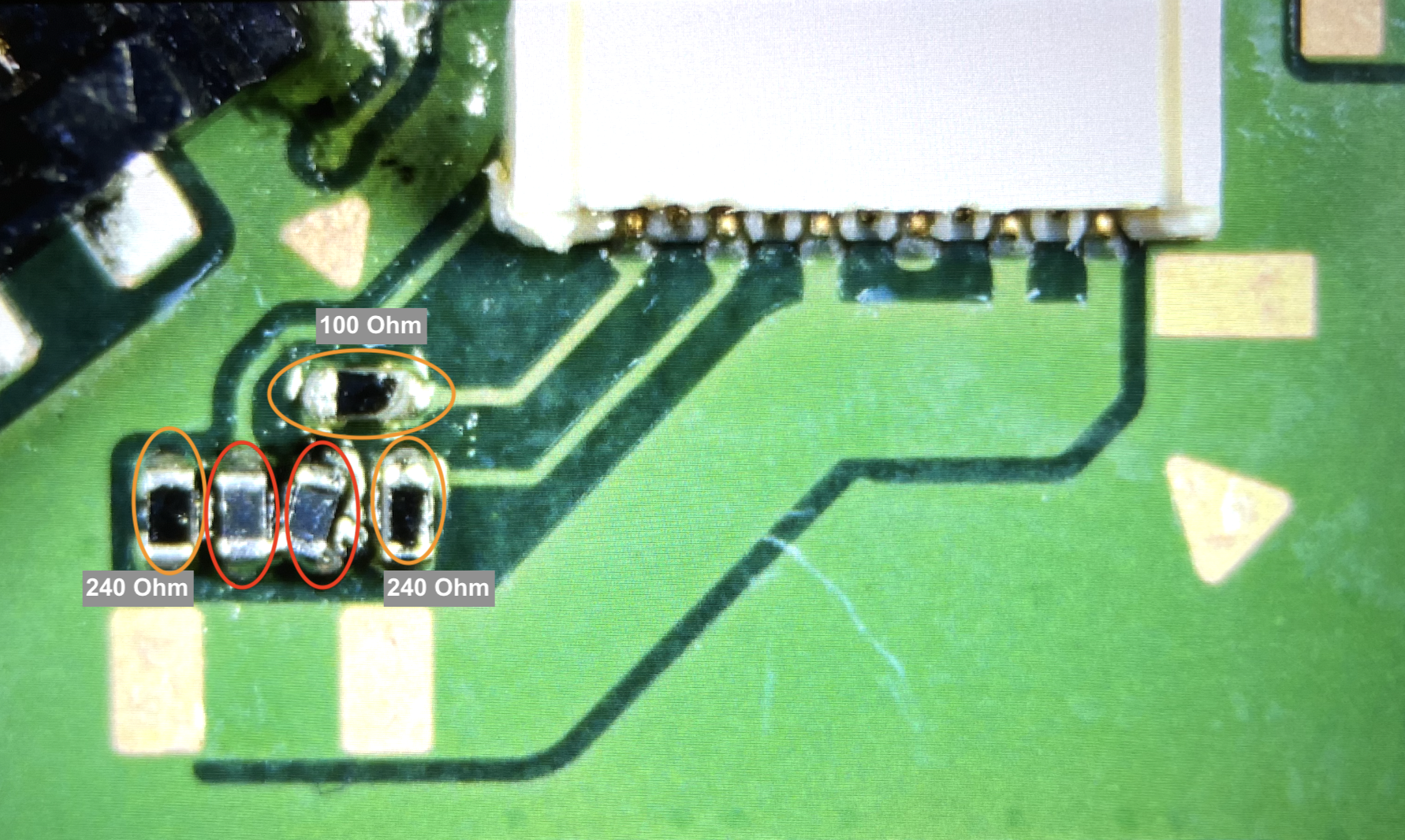

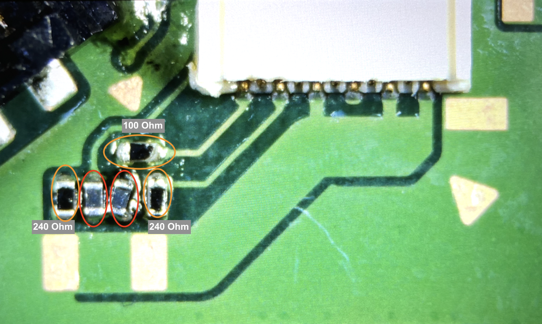

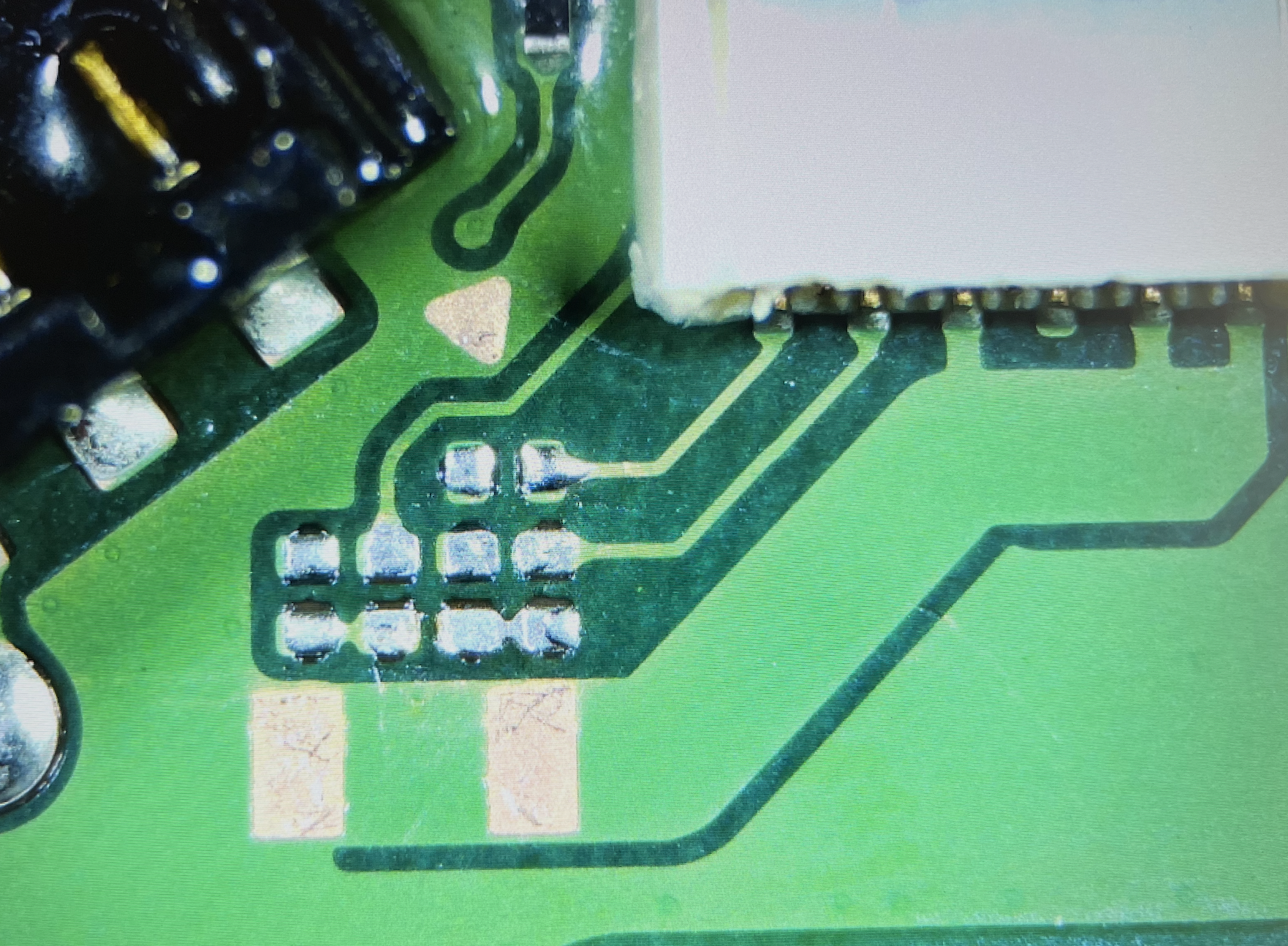

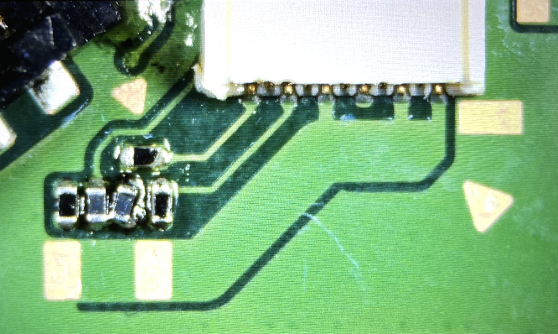

Hey everyone,
I removed a few components next to the left joy con FPC connector in my Switch OLED because of a botched repair. It looked like this before:
And now, cleaned up with the components removed, it looks like this:
Now, I know the following components are 0201 resistors:
Can someone help me identify the components circled in red? Are these inductors?

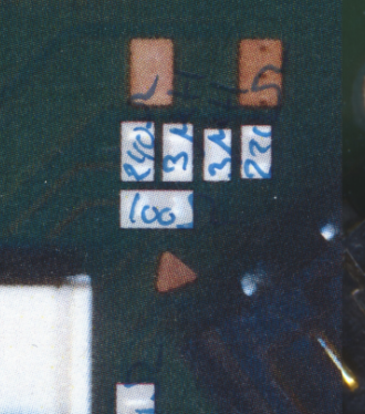

The only schematic I found (https://files.zzattack.org/img/console/switch/oled/Components/top_components.jpg) is a little unclear to me:
Are those components 3 nH inductors?
Thank you very much in advance!

Hey everyone,
-dibas
If the markings are correct (nH == nanoHenryes or nanoHenries?)), then yes, those are inductors.
What confuses me is that the first letter looks like a μ for micro, but 3 μH would be way too high for a component of this size, correct?
Just a quick update, I replaced the components with 3 nH inductors and everything works just fine, in case anyone else reads this later.
