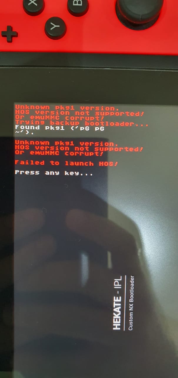

I finally got the time to try this method (off day) but it returned with the same error I got from other methods:
"Unknown pkg1 version.
HOS version not supported!
or emuMMC corrupt!
Trying backup bootloader...
Found pkg1 ('pG pG ~').
or emuMMC corrupt!
Failed to launch HOS!
Press any key..."
Pressing power returns to Hekate menu.
Any idea how to proceed from here?
I have access to multiple working Switch units in case I could salvage any needed files.
or emuMMC corrupt!
or emuMMC corrupt!
Press any key..."
Which method did you follow? The guide I linked has 2 different methods for Mariko units. Also did you try booting with fusee_primary instead from Hekate?

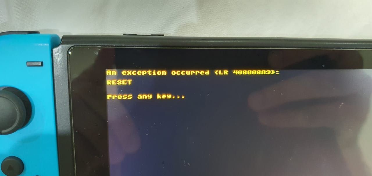

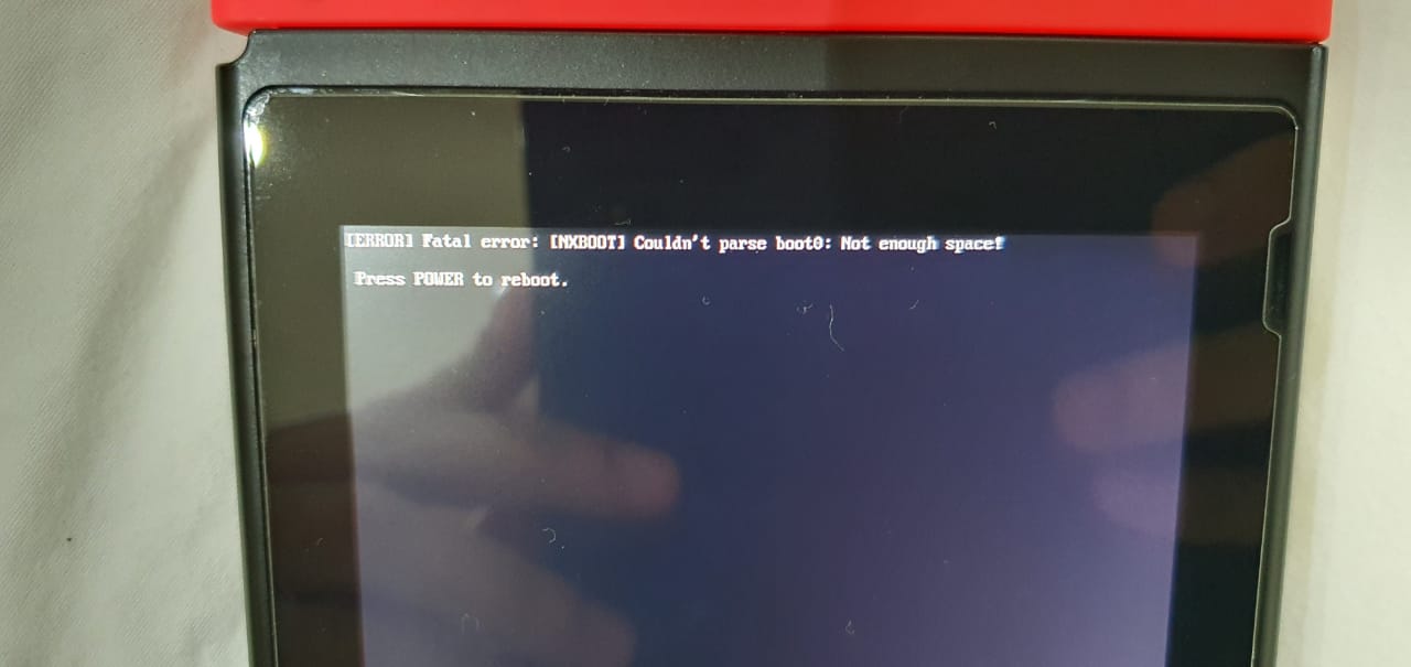

Followed by first fusee primary error.jpeg Error after fusee primary.jpeg Error following retry guide.jpeg
Well do you remember what the error code is now?
I sincerely apologize for the late reply.
I had some recent changes at work and my laptop was away because if it (with all my files and backups).
I got it recently and tested ReTry again with the recently updated Atmosphere but it still didn't work.
I tried again by launching fusee primary manually and I got an other error.
Trying to launch fusee secondary doesn't start whenever I touch to launch it (nothing happens at all).
