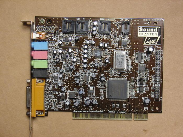

Does the SB 128 support surround sound? Digital audio for playback from an optical drive? If so, those prices are looking much more reasonable :unsure:
If you mean Digital to Drive with an Cable - Yes.
You can see on the Picture 3 Connectors - TAD/CD_IN/AUX_IN.
Surround Sound - Depending on the Modell,some have only 3 Connectors on the Rear (Line IN/Speaker/Microphone)
The Sounblaster 512 PCI has two Output Connectors but only Quadrophonic Output.
This Sound Card(s) has also great DOS Game compatibility.:)
The next Step is the Soundblaster Live! Series (the 1024 or 5.1 Modell with Surround Sound and also CD Digital connector).
I also had this Sound Card with Windows 98 and Windows Millenium and they also works great with DOS Games.:)
Thank you.:)

Then you need the Live 5.1 Platinum Edition.That comes with an Front Panel.Or you can search on EBay for the Panel only.
The Sound Cards from
Soundblaster Live! 5.1
and
Soundblaster Live 5.1
Platinum Edition are identical.:)
The only difference is on the Rear Connectors from the Cards - some have "golden" ones:
Thank you.:)
