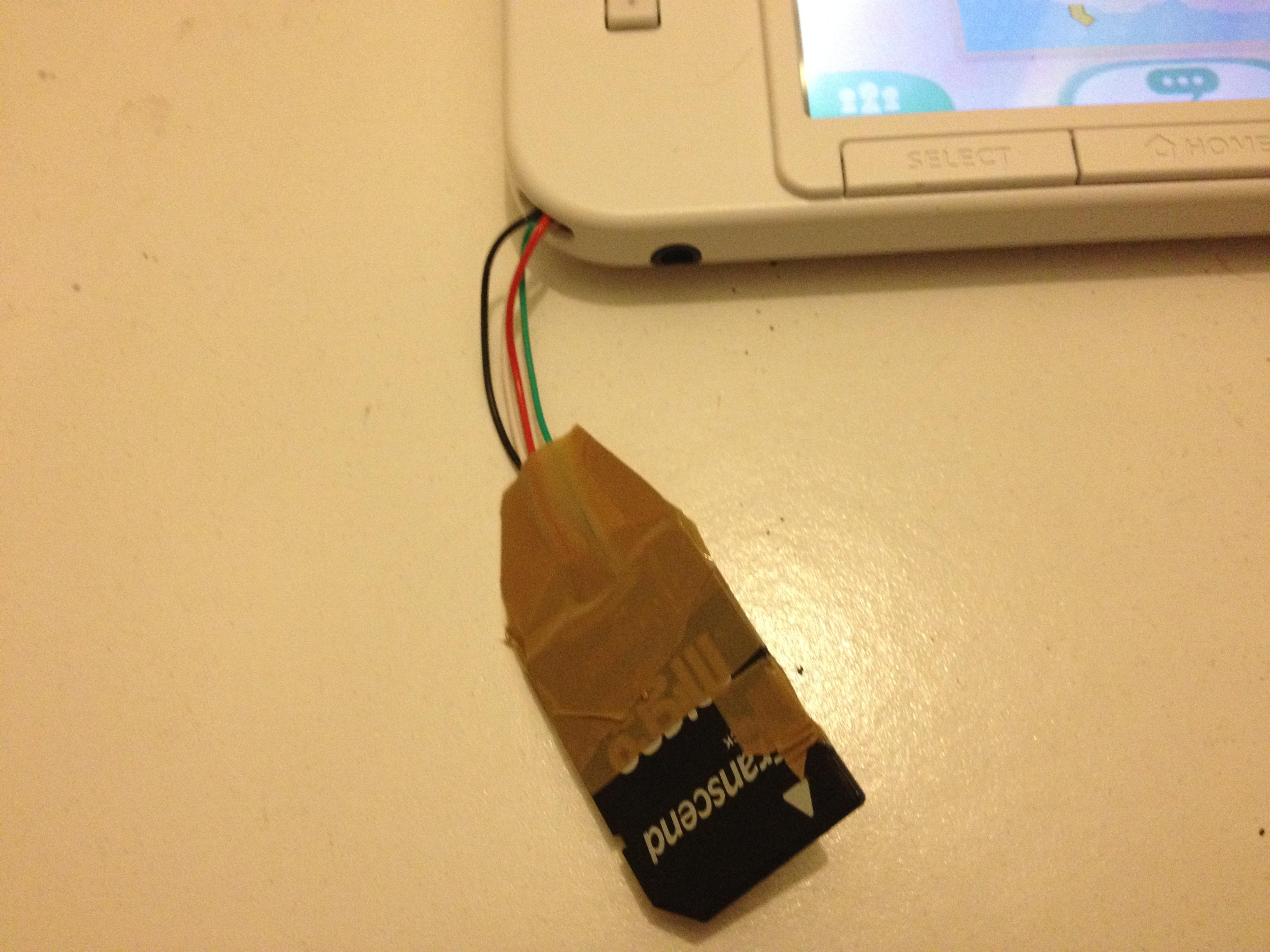

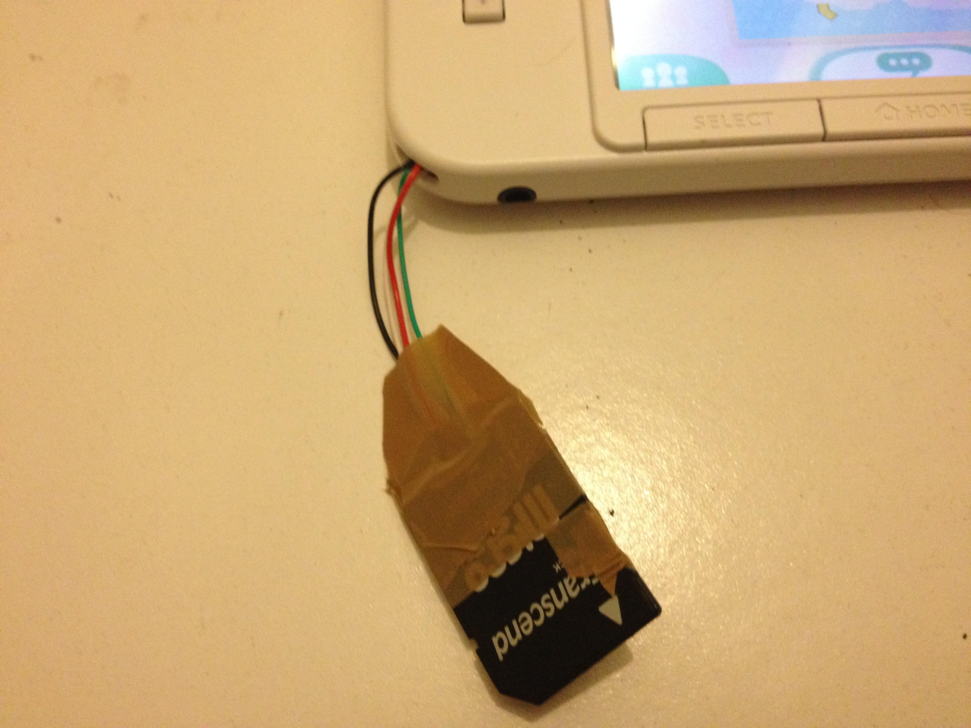

Dump it more than once right after each other and check the MD5 Hashes of the dumps. If they are equal everything works fine, and you SHOULD be okay to write it back (Keep in mind there is a reason I wrote 'should' and not 'will'. There are always things that can go wrong). If not, you made something wrong and should NOT write anything to the 3DS. (For me my cables were too long)

mine look like this ... short wire ...

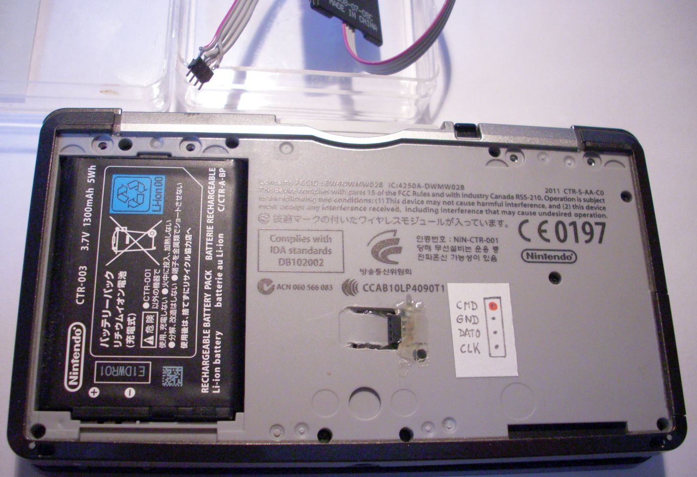

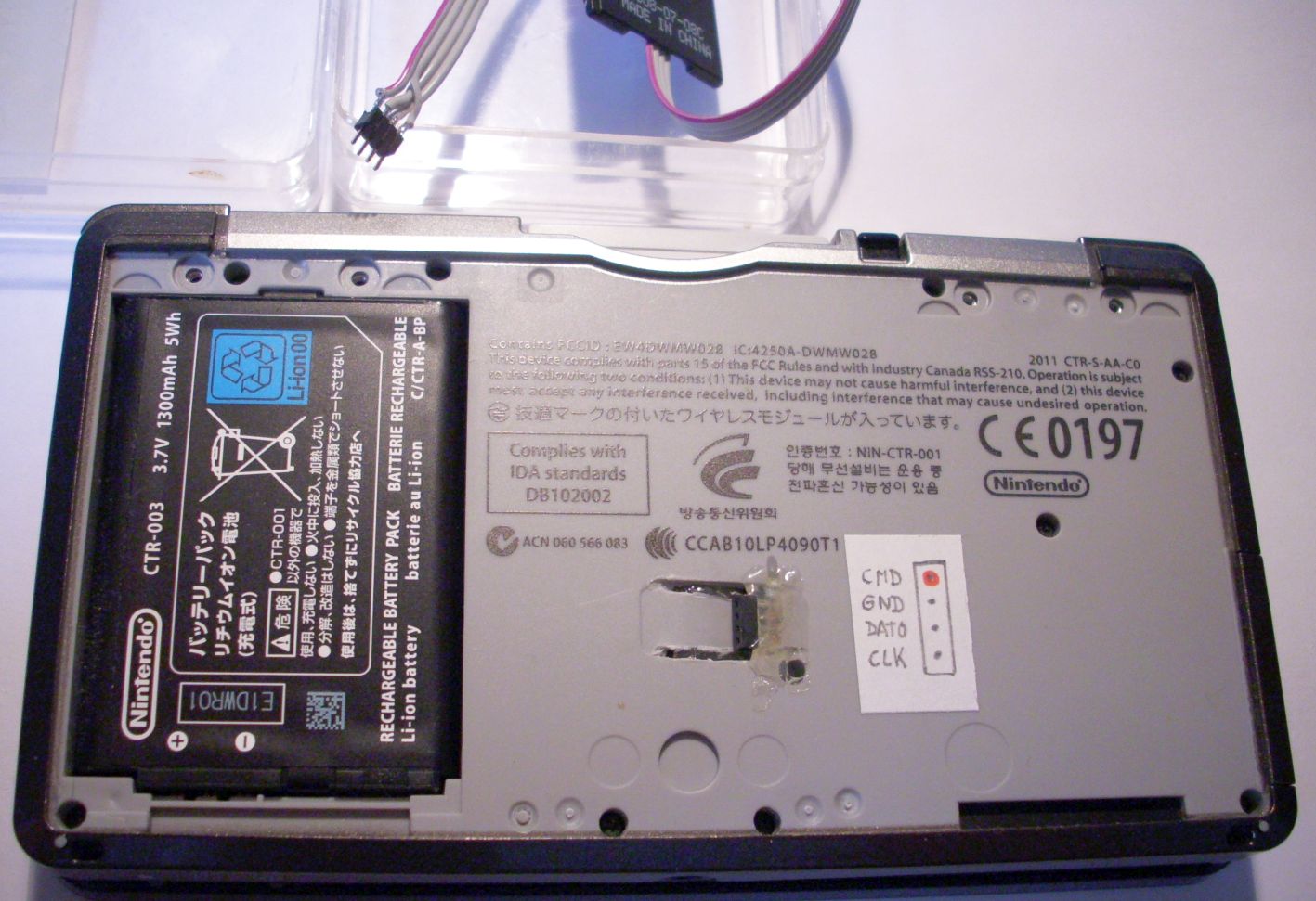

Yay! Just finished my solderless 3DS XL flash kit :grog:
Ordered a White 3DS XL yesterday from amazon.de. Version 4.4 !
I desoldered 4 pogo pins from an old xecuter modchip.
This is my board layout... ugly but works :D
I have not yet made pics of the final board because it is currently in use and I don't want to change a running system :P
I marked the spots in red where I put my pogo pins.
The flasher leaves NO TRACE ;)
