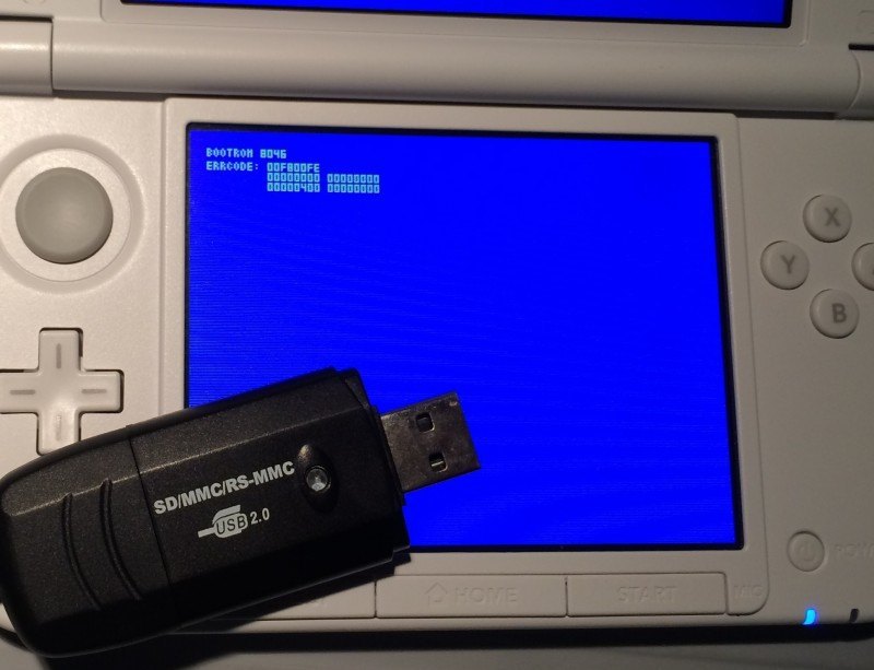

Alright folks... so I shortened the cable since I am reading some people had issues from their cables being too long. This is now really about as short as the cable can feasibly be without having the back of the console constantly open. I KNOW I am seeing images of people's work with much longer cables than this...
My new error:
00F800FE
00000000 00000000
00000400 00000000
3DS XL boots just fine except when in the SD card reader. It boots to that error when plugged into the SD card reader (but no power).
Another thing I am reading is people having issues with certain SD card readers... So can someone shoot me a link or a model number or SOMETHING of SD card readers that are known to be working for them?

if you're already in blue screen, when you plugged it in your pc,
windows should prompt you to format [press cancel and continue].
or try usbtool
http://www.alexpage.de/usb-image-tool/download/
and see if it can detect your sd adapter.
sometimes windows doesn't prompt me to format.
or try another SD usb reader. like this one.
there's alot on ebay.
or try usbtool
Thanks for this. I was thinking of going out and buying another tool. I was reading that something that ONLY does SD cards may be helpful. I am not sure I can find anything like this locally (but I am going to try my damnedest). If I cannot, I will buy locally.
I downloaded the tool. Unfortunately iy doesn't detect the reader. :( Just to be clear, it should only detect the reader once the card is in it, correct?
