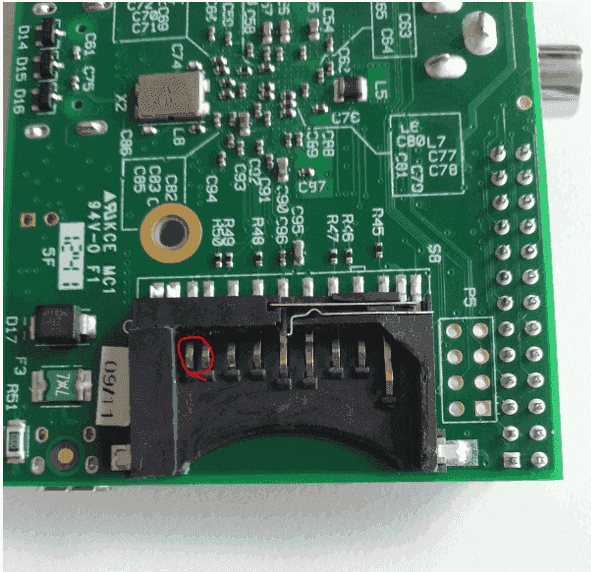

I'm in the same boat... I can read all day long but not write. I get the I/O error, and when I try and use a built in card reader I got the error that the "Media is Write Protected" any thoughts?
If the reader is telling you that write protection is enabled , bridge the two leftmost pins using some tin

I had to bridge the two lock pins on the cardreader, but now my screen is yellow tinted XD I just cant fix this shit :P
