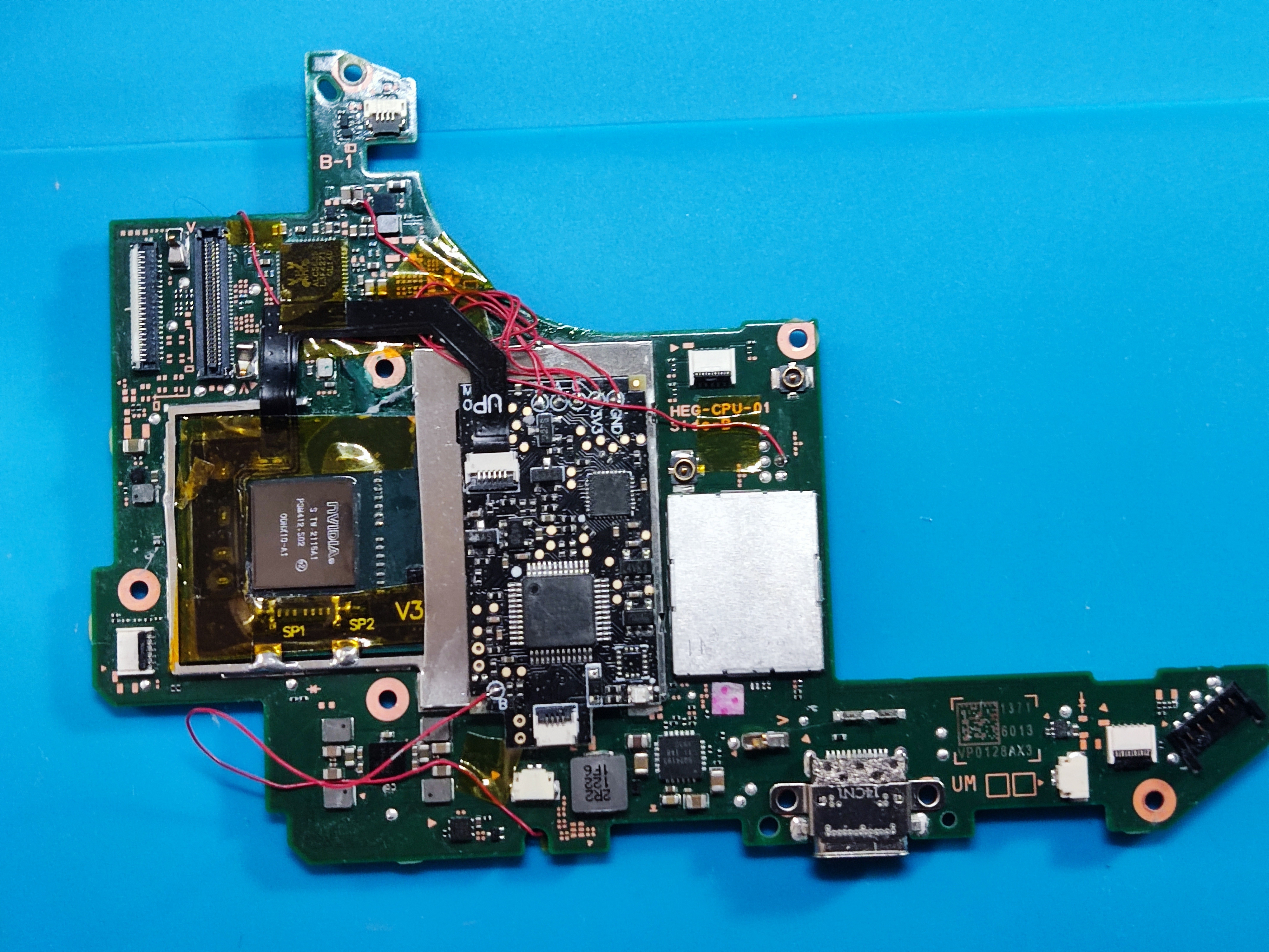

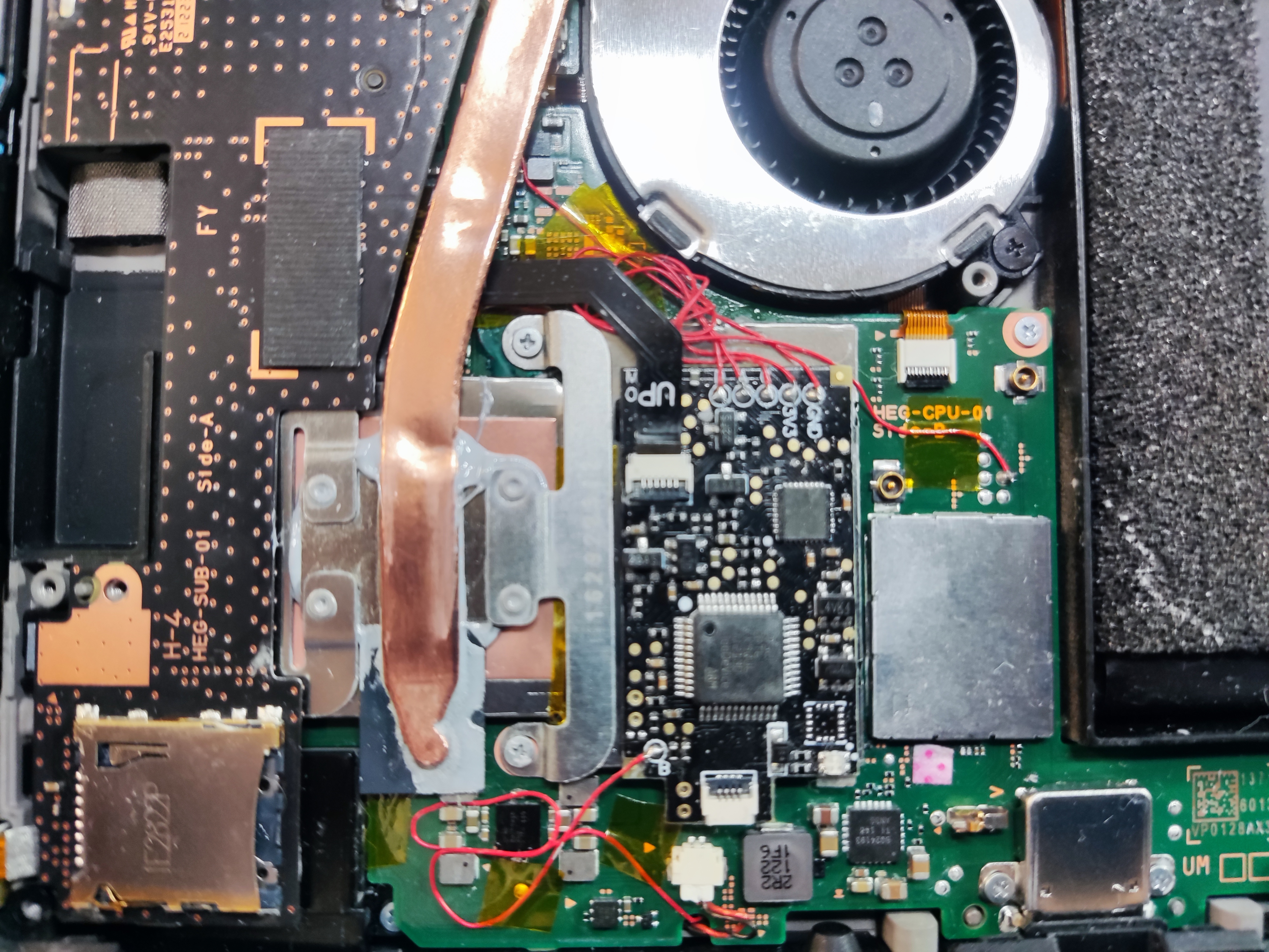

I will inspect properly. I believe and hope it's not the connector on the board. This Switch is new, I used it a little and only opened it to install the HWFLY Chip. Thanks for the suggestions.
Thinking a bit further, I suppose it is theoretically possible that something on the switch mainboard was damaged when the HWFLY install was done but I'm not familiar with the power/volume button circuits. Inspect the areas where you were soldering for missing components or solder bridges. IMO something with the connector/ribbon is more likely since you have to disconnect and manipulate it to remove the board and do the install.

Well I hope it's not, because after installing the HWFLY chip the buttons were normal, this just happened when I decided to open it again because I was thinking I hadn't connected the fan correctly. I inspected the fan and when I closed it this happened.
So just updating everyone on the situation, I inspected the flex ribbon power cable, cleaned it with isopropyl alcohol, the problem continued, I solved it then by inspecting the Switch motherboard, I took the motherboard out and cleaned everything with isopropyl alcohol, looked the welds and they are all good, I looked at the board to see if I could identify anything missing and I didn't miss anything. And I'm thinking that the problem is not the flex cable, but something on the board that I couldn't identify, for me it's all there.

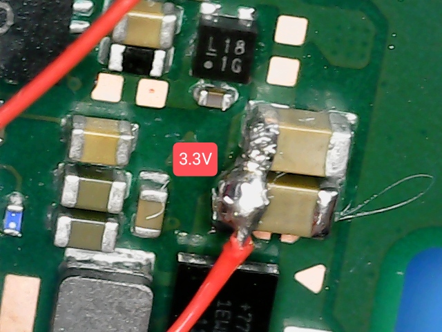

The only thing wrong with my solder is that when I soldered the 3.3V wire to the capacitor, the solder ended up sticking and joining the other capacitor. As you can see in the photo.
I wasn't worried about it because I had seen a video on the ModzvilleUSA channel! where he joins the two dots and he said no problem.
Do you think this could cause any problems? I tried to separate it but I couldn't.

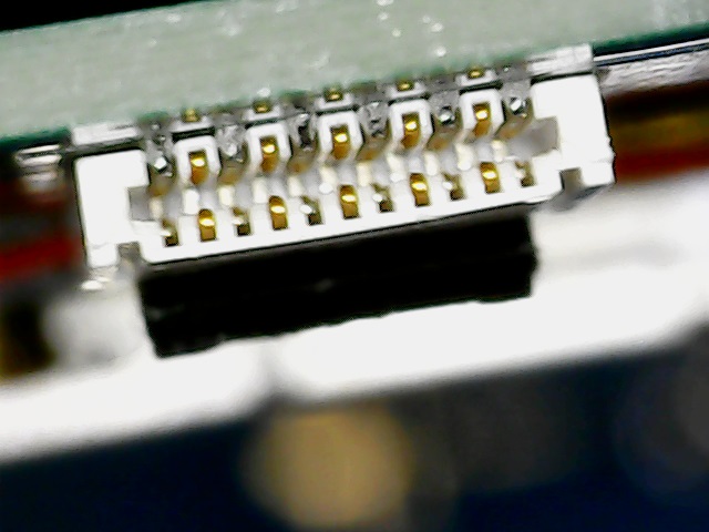

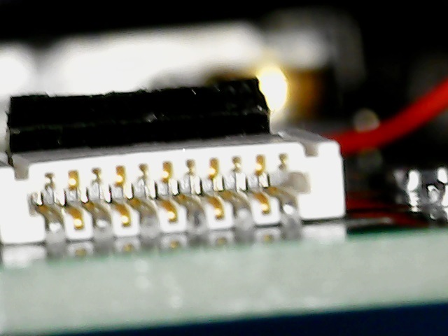

I also looked at the flat cable connector with a microscope to see if there was anything making a jumper, and by the photo it is clean.
View attachment 307315View attachment 307317View attachment 307318

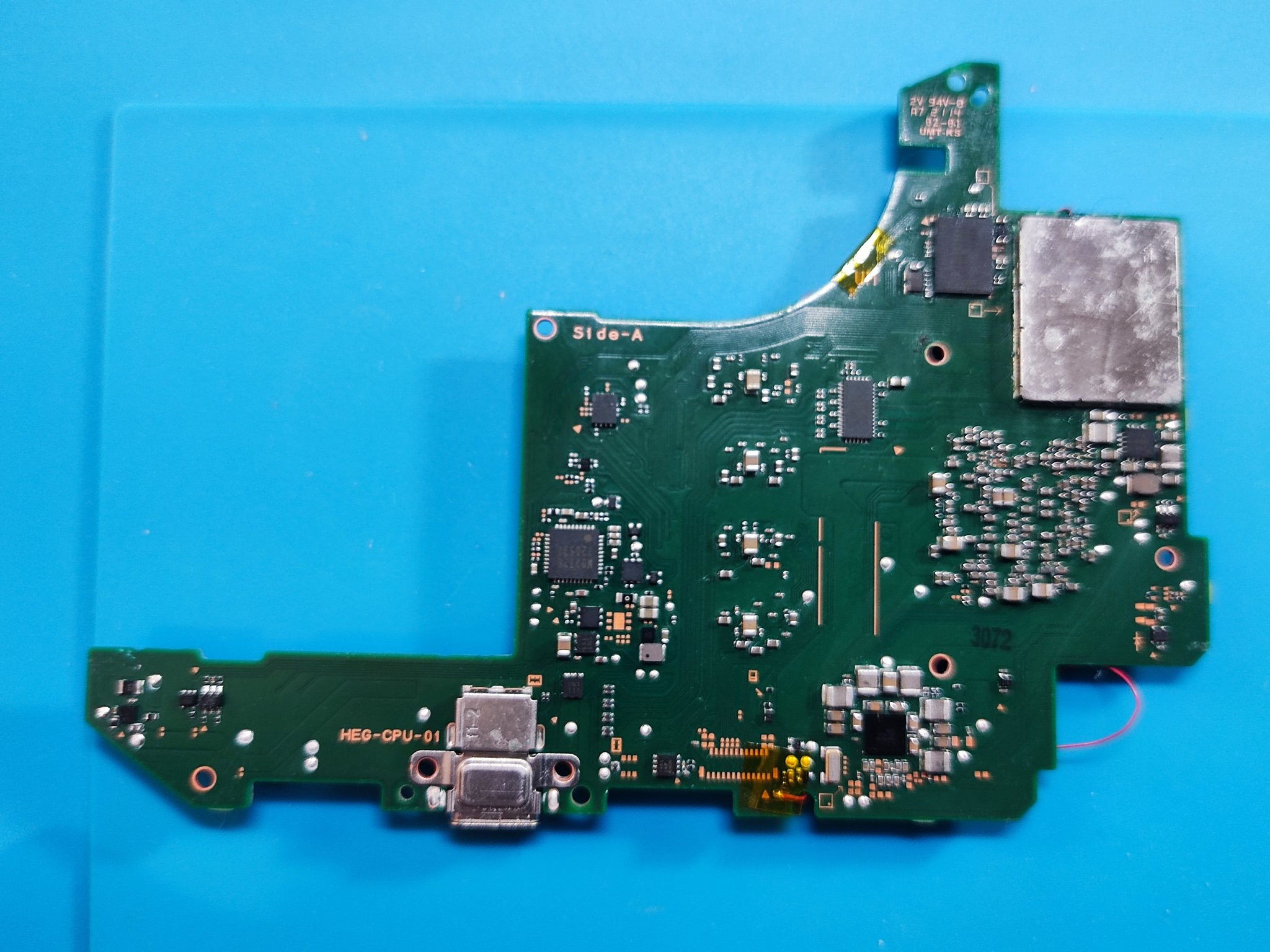

Guys, I come here to tell everyone that I managed to solve the volume impediment. I don't know how I even gave up because I had done all the tests until I removed the motherboard from the Switch and cleaned it all with isopropyl alcohol, I had also tested the flat cable and ended up identifying that the obstacle was not there, I also looked with a microscope at the flat cable connector on the motherboard, there could be something there making a jumper. As I hadn't found a solution, I was going to leave it as is because all the other features were perfect, the only obstacle was adjusting the volume through the physical buttons, but I could adjust it through the joy-con home key. So, looking at a photo of the board that I had beaten, I decided to open the Switch again because I was thinking that the Kapton tape was interfering with the contact between the heatpipe and the processor, so I removed the tape and replaced the folder again and when I closed it and went to test the volume was working perfectly.
Before anyone says it was Kapton tape, I want to warn you that it wasn't it, I put it on after cleaning when I tried to fix it the first time.
So far I don't know what could have happened, but I'm very happy and grateful for everything. I want to thank everyone who offered to help me with tips. Thank you all and stay with God.
