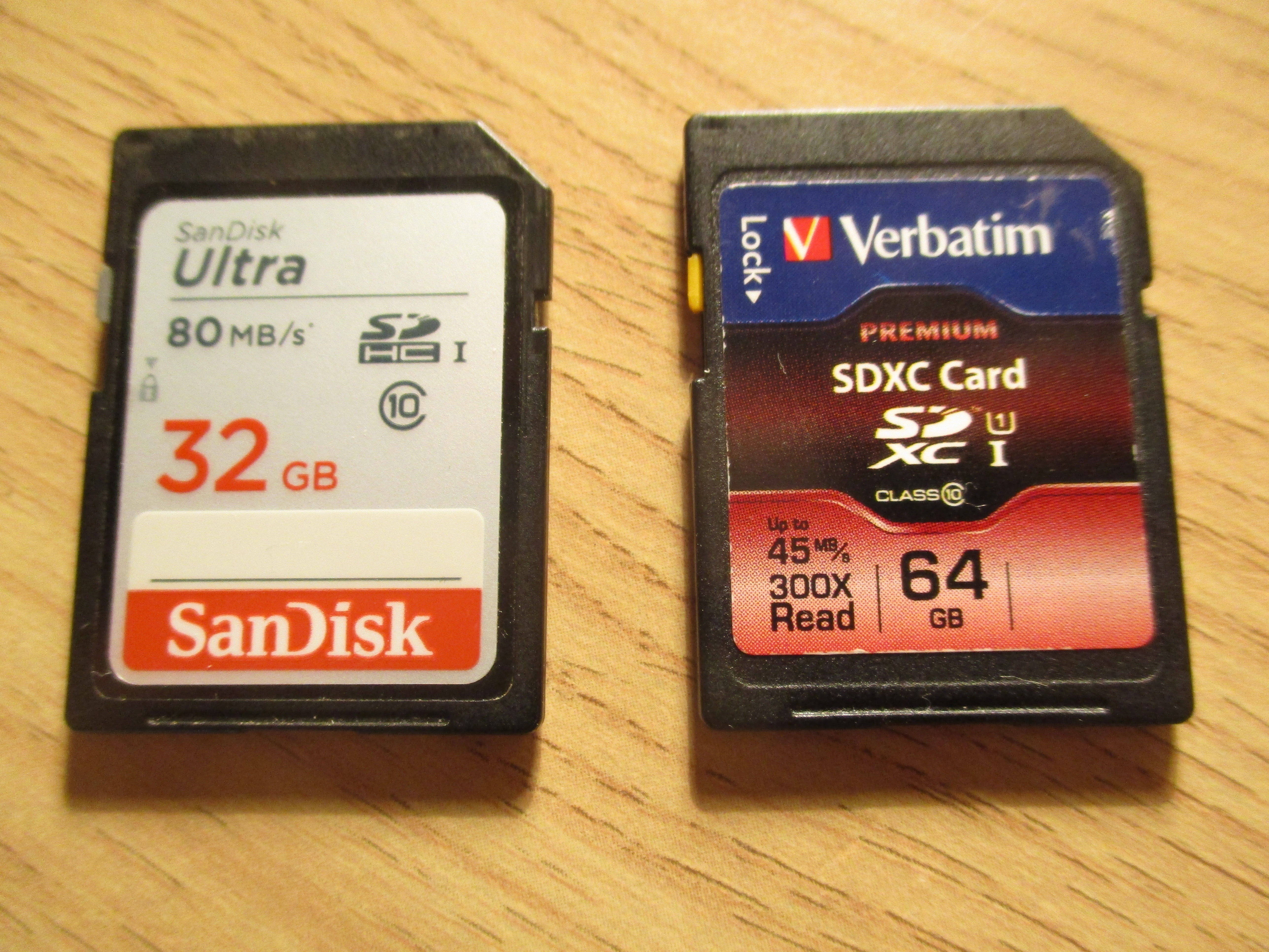

I use these two different SD cards (they work correctly):
