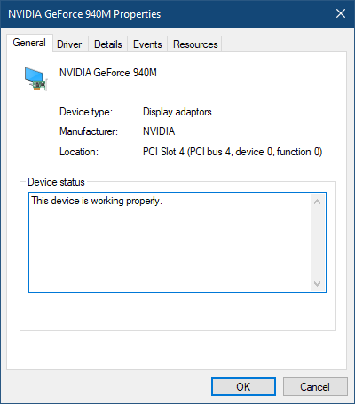

I could install a driver for it so that it shows up in Device Manager as something other than Unknown Device, but it still doesn't work.
Cause to me , this is considered working , as it show Geforce940M, I had a similar case to your where I had to edit nvidia inf, I had a GTX 645M on a sager laptop normally doesn't support it, original card was a GTX 485M where I had to edit the inf. I just used that modified files even if I did windows feature update.
Mine shows up in Device Manager, but has errors and I can't actually install GeForce Experience or the nVidia Control Panel to use it.
M cards come with their own version of the control panel did you try installing it with the vendor provided driver packages?

Thanks for the advice, but sadly I got this error both before and after running DDU (Fig. 1). Additionally, the GPU now shows up in Device Manager like this (Fig. 2) (no, clicking Update Driver doesn't work, either).
