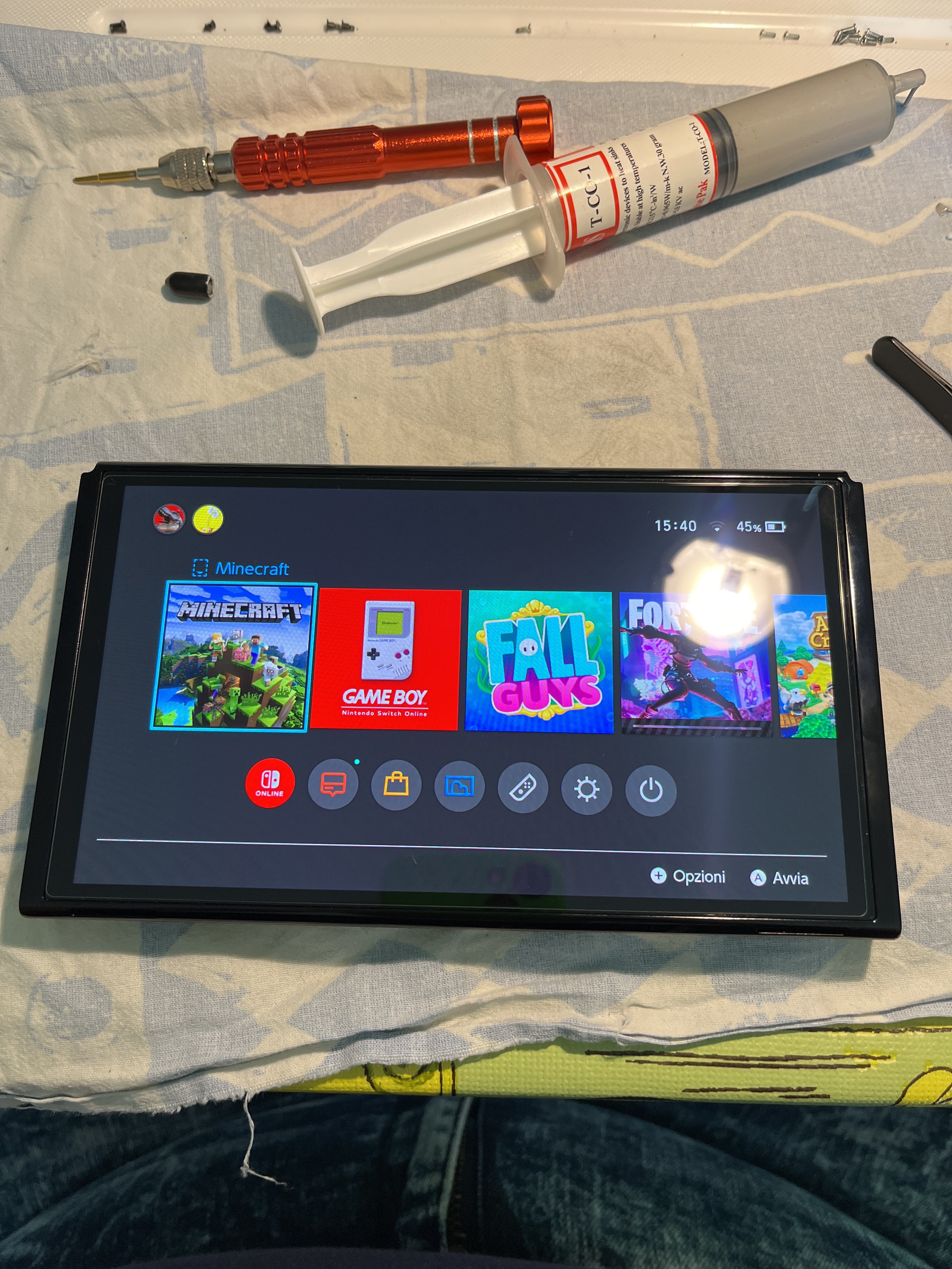

I fixed it and the console starts normally! there was a jumper on a resistor in the processor, with a lot of patience I managed to remove it and now the console works normally. My goodness!
Next step is find someone to modify my console
This thing just isn't for me
