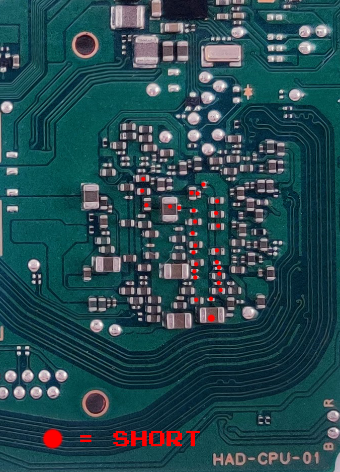

nsw1 No video output too dock charging ok / dock light is constant green):
Has a lot of shorted caps on the back of the motherboard (back of the tegra chip). Picture is included
I have replaced the p13usb and the usb-c connector. This did not fix the shorts.
Where to look next?
About the first Switch : you're probably measuring a short somewhere else instead of all those individual caps.
They are all on the same power rails.
From all the repair videos that I have watched so far, most shorts are either in the USB or charger IC and the caps/filters around them.
If you have the equipment, just take out those two chips and start measuring for shorts in those areas.
