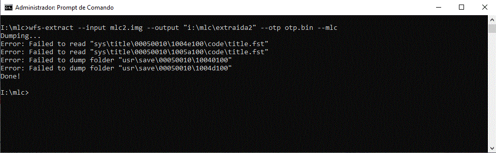

In fact i wanted all files, because i don't know what exactly is wrong im my dump.
But when i extract my dump, i got some errors in these folders i've mentioned.

Before the brick the console worked normally, the error happened after I used FailST to patch the "health and safety" native system app, after applying the Failst patch, I opened FTPiiu, so I don't remember exactly which one folder I went, if it was 0050010-1004e100(Health And Safety) or 0050010-10040100(Wiiu Menu) and pasted 2 files, cos.xml and men.rpx(patched with Home Brew Launcher). After that I pressed the home key, to go back to the main menu, but the menu didn't open, I thought it was some silly error and decided to restart the console. After that the console shows error 160-0103 after powering on.
So I figured if I dumped mlc and injected the correct files back, the system would work again, the problem is, I don't have those files.

That error is when there are blocks with bad hash....
You can maybe fix the files by injecting them, but you can't fix the folders, as their metadata is probably corrupted.
If you want that I will investigate that corruption and see if it is repairable by recalculating the hash you can send me the dump and otp privately
I am working those days to add writing capabilities to my tools, but it is going to take time, so deleting corrupted folder and readding it is not possible yet, but hopefully will be possible. I can write chkdsk like utility for wfs :)

this actually worked for me, because I had one bad file, the BaristaIconDataBase.dat. I did inject it after compiling a new version of wfs, since the original had an issue with locations that were in uppercase. I think it would say it couldn't find the location. that was my motivation behind that. it did in fact work, so now I have no errors when decrypting my mlc. I just used ftp to grab the file.
Yeah I have to fix this bug, but the workaround is just to specify the path in lowercase.
