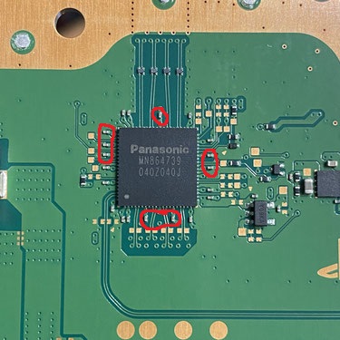

I hope someone can help me out. Got a PS5 with no screen but white lite. Also can see the console in my network.
Of course I checked the HDMI Port, all pins are solid. I checked the diodes around the HDMI Port, both sides of the board. Good!
I desoldered the Panasonic Transmitter IC and bought a new one.
While I was soldering the the new IC to the board I noticed that I made a HIROSHIMA!
8 caps around the Panasonic IC are missing now
Maybe someone knows the values of those caps, are they all the same ?
I would really appreciate some help.

For everyone who wants to know the answer....
I found the solution elsewhere after hours of searching.
That are 0.1uF 0201 6.3v Caps.
-Brassmann
