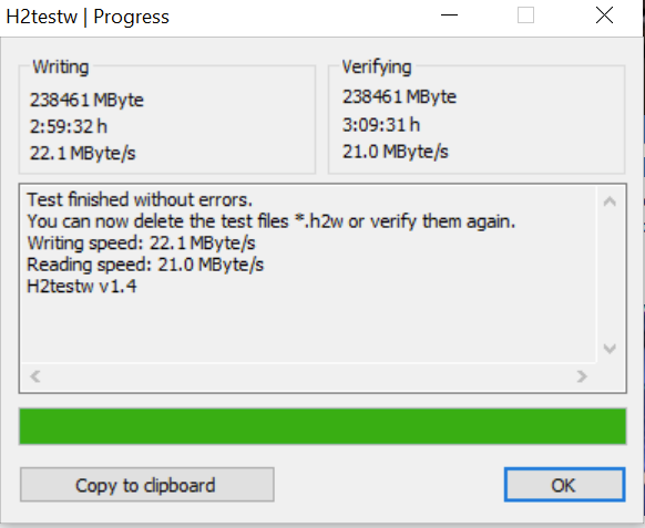

it's legit. it just finished:
I don't even worry about that stuff haha I buy microcenter mostly and its from microcenter
and in this case, team group was sold by team group as well.
Id be a lot more cautious of other microSD's shipped+sold by amazon since ive heard they source counterfeits mistakenly a decent amount
Reactions: godreborn
I check all just in case. :)
