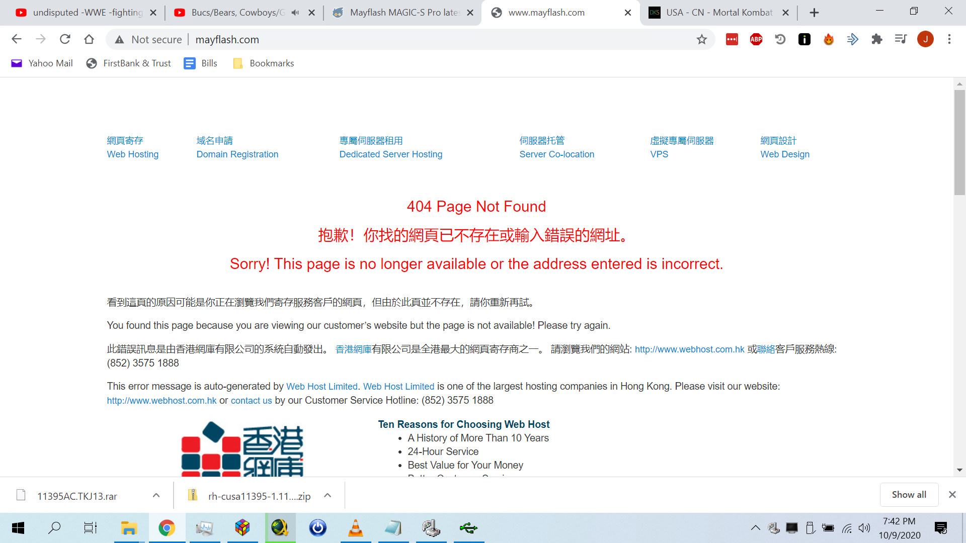

Hello guys, due to recent disappearing of the official mayflash website i am here to ask you a favor... anyone knows a place to download the latest firmware of my newly bought Magic-S Pro, please? cause i can't connect my xone controller (4.8.1923) to it. i think it's firmware 1.06. thank you in advance for your time!
The latest I could find was v1.03. Sucks there's no mirrors for these downloads. I guess the site will be back up eventually tho..

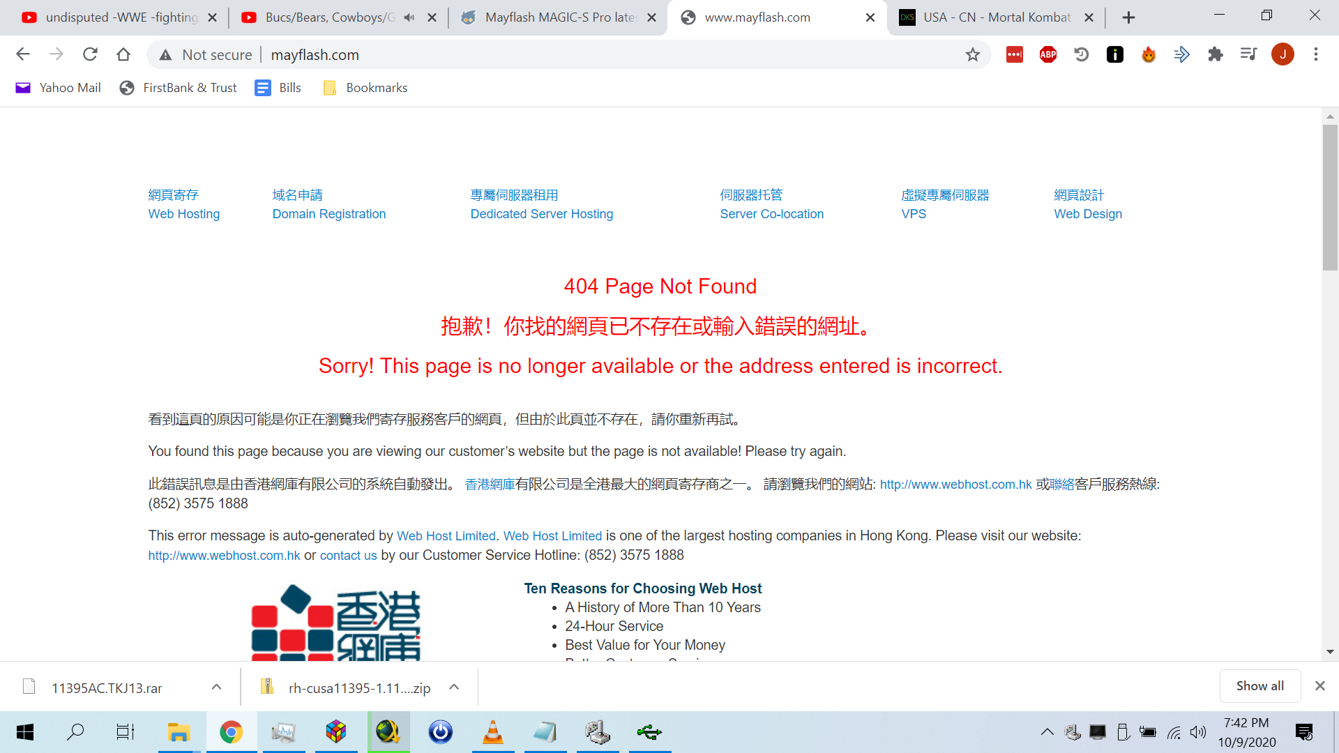

It does not seem temporary to me. If you go to the download page you get this (although the last option says temporarily unavailable so maybe)
404 - File or directory not found.
The resource you are looking for might have been removed, had its name changed, or is temporarily unavailable.
I used Wayback Machine to get the v1.03 zip sadly there no newer backup so cant access the v1.06 zip
