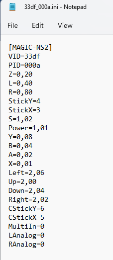

So I have been looking at this thread and discovered that I could use the Maylfash Magic NS to connect to Xbox one s and switch pro controller to use on Nintendont on the Wii. I have had great success with that but with one problem: The Xbox One S Bluetooth controller won't even work on the old model of the Magic ns so I had to get the newest model of it which is the Magic NS 2 which fixes the issue with the Xbox one controller and lets it connect (because of a firmware update of the controller itself changes how Bluetooth works or something).
The thread had only mentioned the Magic NS1, not the Magic NS2( since the thread is old now), and since there was no file to let Nintendont recognize the Magic NS2 I had to make the controller file myself and found a nice piece of software that can do it for you which I found here and after that, I saved the config and copied the ini from the exported ini controller file to the controller folder on my SD card and tried it on my Wii. I launched Nintendont and put the Magic NS2 in dinput/ps3 mode which is dark blue, my Xbox One controller connected and every button worked but the D-pad didn't
So I need some help to find out if there is something wrong with the ini file so the D-pad works
the ini file is inside the rar file I uploaded here
If this works, then we can use the Magic NS2 on Nintendont

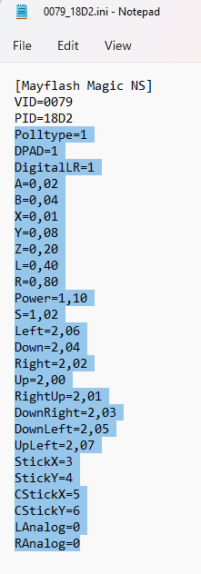

I MADE THE MAYFLASH MAGIC-NS2 WORK
So what I did do to make it work with all buttons responding in games etc, I took the .ini file from the thread that is about the Mayflash Magic-NS1 and took the code
After that, I took the button binds and pasted them over the one I had made and saved it
This is before
And this is after
but to make it work I had to copy over this line of text from the other thread I mentioned
Both the Mayflash Magic-NS1 and NS2 work the same but the NS2 has added more compatibility with other controllers so I want you guys to test it out
Credits to the other
thread
