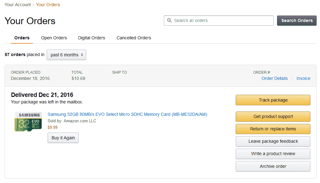

Well, it appears that i have bought a fake samsung evo 32gb card:angry: from amazon, dammit, i´m using a 8gb sd card that got here and voilá, can load hourglass, successfully dumped hs.app, injected fbi, and now will proceed to complete the guide. God dammit, it was the card all the long...
Thanks friend for helping me, ill post the results after i finished the guide.

The fun part is, i bought from amazon thinking that would be safe, guess i was wrong, at least i got the refund i requested.
Went to a shopping mall today, and bought a class 10 64gb toshiba microSDXC UHS-I Card with sd adapter for 21€. And so far, its working like a charm on my new3dsxl :)
