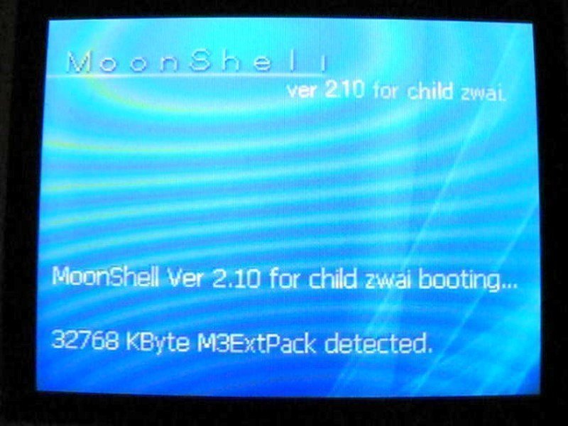

Moonshell displays memory in 'kb', so 32000kb is correct. You will probably find it says 32,768kb, which is 32mb. The GEP has 32mb of PSram, so the amount of ram being detected is correct. What is your slot-1 card, and how are you loading your GBA games. M3, GBA ExpLoader or YSMenu?

Here is how my working GEP is detected in Moonshell:
