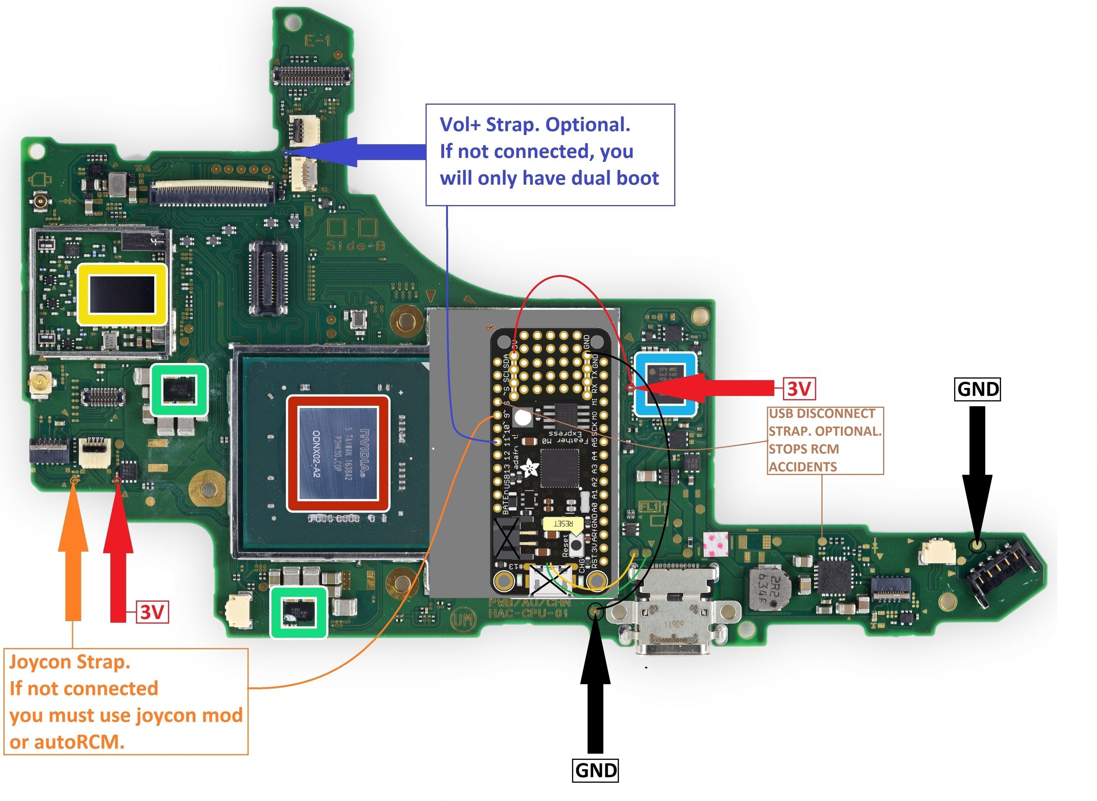

I modded my Switch a half year ago. After the installation I had no time to test and play with it. Now i have time but i totally forgot about this and how it even works. :D
So my Vol+ dont work. I mean it show me some Lights on the M0 but i cant make the Volum lauder in a game. Im stuck with 0 Volum. Is there a way to bypass this or something?
i guess you have to open it up and resolder the vol strap. might have bridged it? usually you can still use vol buttons :x
Then why i can still boot into RCM with Vol+ and Power or navigate in RCM? Im pretty sure I soldered good, because i tripple check everthing.
So normelly you can use the Vol+?
https://gbatemp.net/attachments/feather_final-jpg.197966/ this is where i solder mine.
It can be any number of things, honestly. If it's related to the Trinket installation, It's likely you have a solder bridge. But it could also just be. faulty volume switch. If you want a work around, just hold the HOME button until the onscreen overlay comes up and use the volume slider there.
