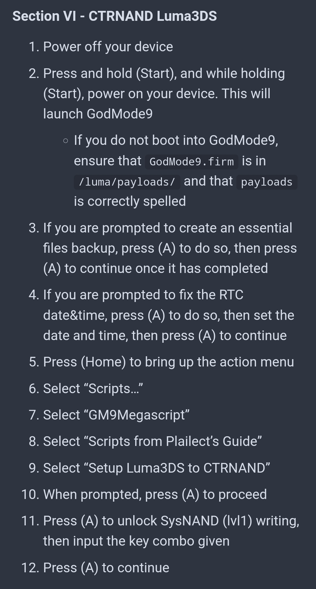

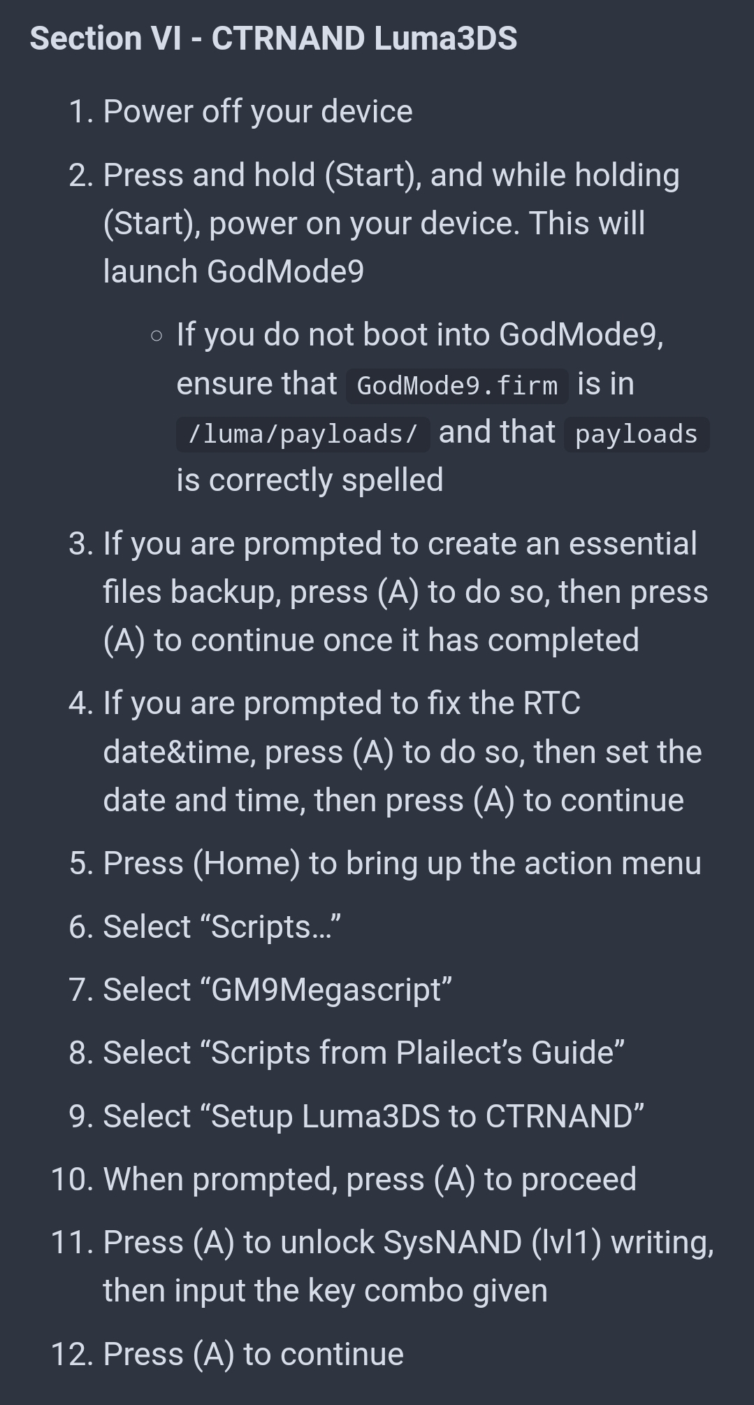

Dude, just follow the steps in the img below, it is in the guide, and you weren't supposed to do it manually..

What? GodMode9 is IN the system, and you only need to put the latest Luma3DS file on CTRNAND, so it'd boot correctly when you turn on the system without an sd card inserted. That's it.

Do what again? If you did follow the steps correctly and installed the latest Luma3DS on CTRNAND, then yes, all you need is reboot the system and it'll show you the Luma3DS menu, click A on "show nand or user settings.." and press Start.

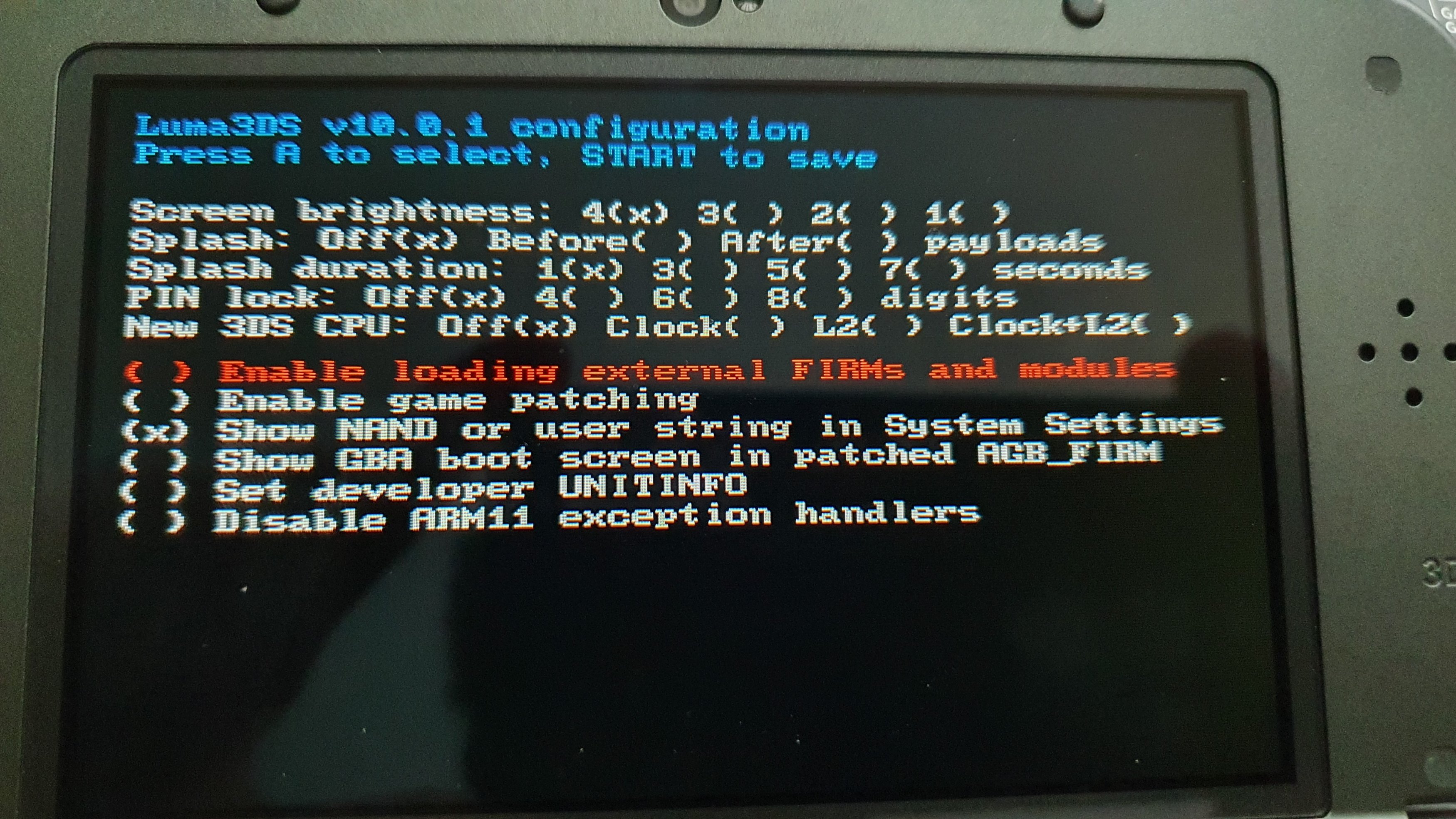

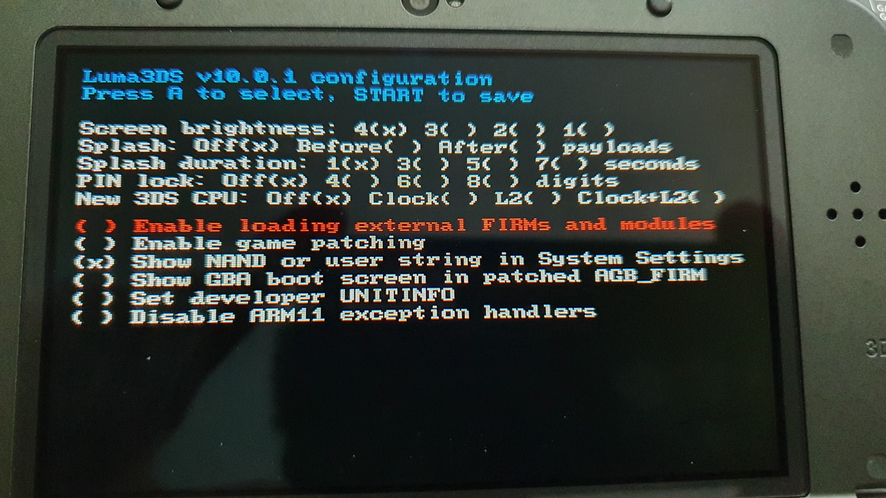

Earlier in the thread, I said I originally deleted the godmode9 file that was in luma/payloads because in step 5 of the A9LH to B9S source, it said it wasn't going to be compatible with boot9strap compatible luma3ds versions. The godmode9 menu opens now and I have already set the luma3ds configuration menu as it shows on the picture you've provided, only difference with mine is that it says luma3ds v10.3 configuration and it doesn't have the new 3DS CPU but that's probably because my device is a 2ds.

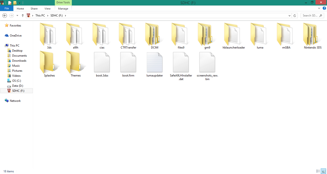

Sorry that's what I meant when I said if I needed to put boot.firm in the CTRTransfer folder, it's the closest thing I have to ctrnand. Here is a screenshot of the files I have on the sd card:
