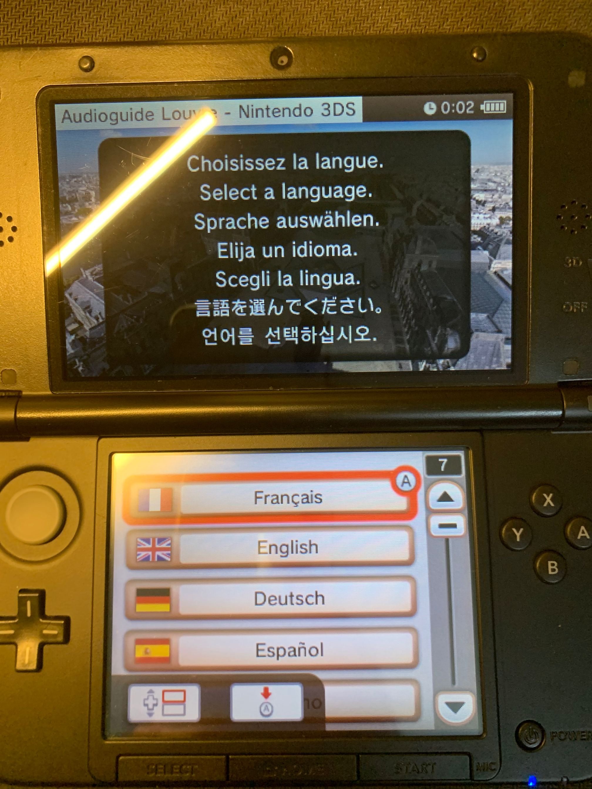

Ho acquistato una Louvre 3DSXL dal mercato cinese dell'usato. Può essere avviata senza la "CTR Guide Boot Card".
Questo 3DSXL è dotato di un menu HOME utilizzabile e di una guida audio del Louvre in 7 lingue.
Sembra un'unità di sviluppo, è possibile eseguire software per la vendita al dettaglio?
I bought a Louvre 3DSXL from the Chinese second-hand market. It can be boot without the "CTR Guide Boot Card".
This 3DSXL have a usable HOME Menu and Louvre Audio Guide in 7 languages.
It looks like a development unit, is it possible to run retail software?

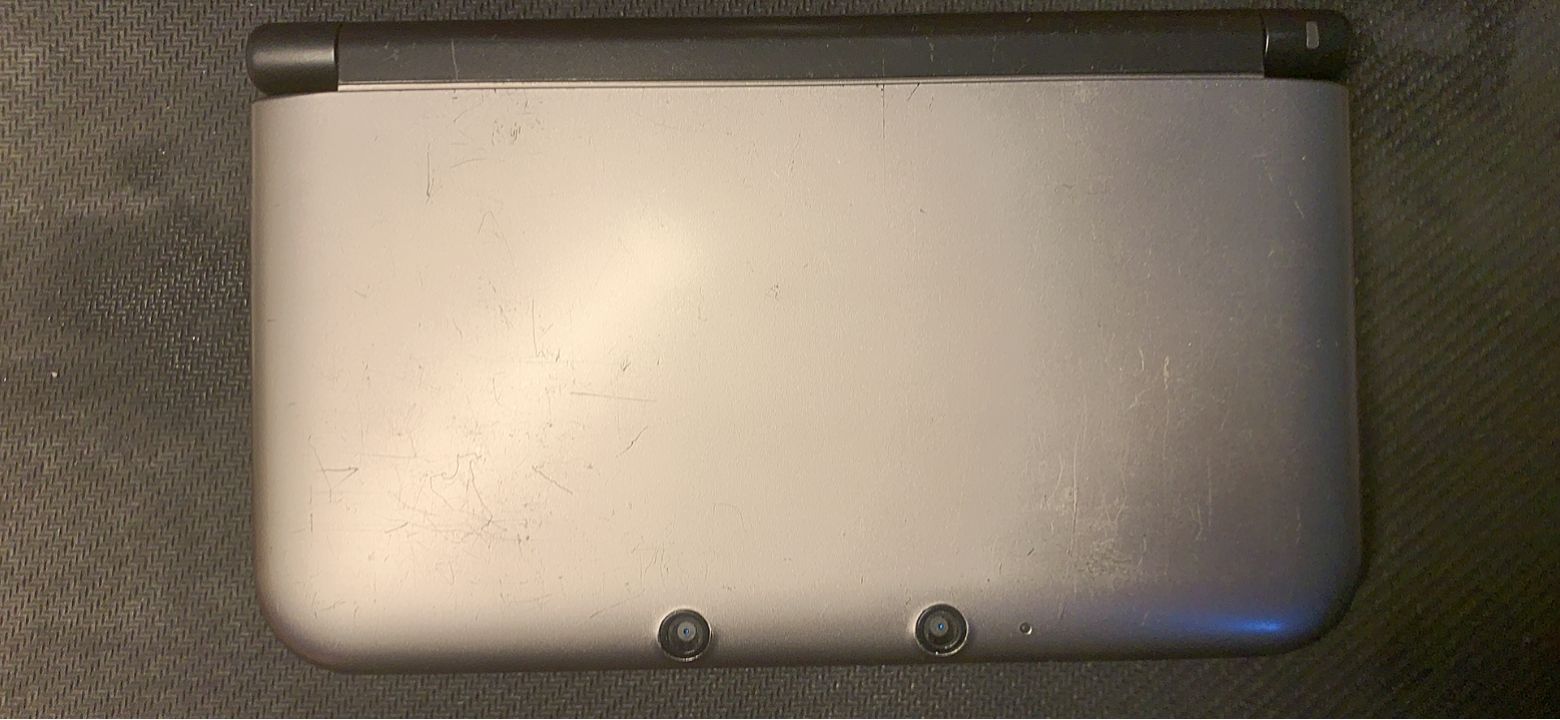

Hi, I need help bringing this Louvre 3DS XL back to life. I bought it by chance (for spare parts) and had never heard of this type of console before. However, I'm very knowledgeable about repairing this type of console and had never seen this purple screen. So I became suspicious, did some research, and discovered that it was a rare console. Unfortunately, the micro SD card was lost, which is why it won't boot, while the original game cartridge was fortunately sent to me with the console. Can anyone provide me with the files needed to boot it?

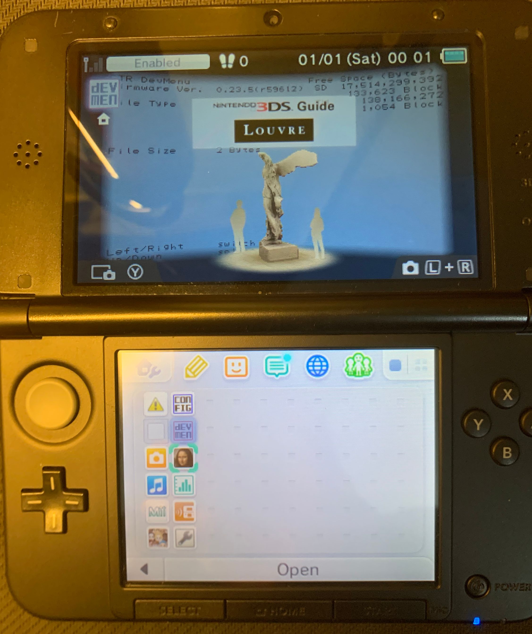

I have a unit in the same situation.
Normally, with the Audio Guide Louvre Old 3DS, you can access the Home Menu simply by removing the boot cartridge, but with this console, no matter what I try, the screen stays completely black and I can’t access the Home Menu.
However, one thing I do know is that this console has a feature called config.mode (DebugMenu, Settool, BeaconCheck), which allows you to change the boot method.
You cannot access config.mode on other Audio Guide Louvre Old 3DS units.
That console is likely different from other Audio Guide Louvre Old 3DS units.
Is there anything I can do to help you?
