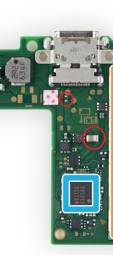

Hello everyone,
I have looking for in somes topics to find my answer but no succes, this is why i ask directly my question here,
Do you know what are the values of theses both components on my broken switch lite ?
the black one seems have no continuity and the brown is shorted. I will replace USB-C port but not sure if the black component is broken or not.
Many thanks in advance,
didifou

After removed USB connector and removed from the motherboard, the brown one (capacitor?) is still shorted
there are anyone with a functional motherboard to tell me the value of theses both component ?
many thanks if someone help me ;););)

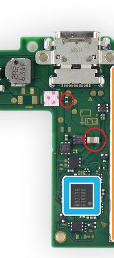

cap should be 10uf 16v 0805
TRY remove m92t and see if short gone.
those two components should be similar value from NS non-lite board like red circle from picture below
ok thanks, short isn't present on the pads ;) and no short around the m92t chip
I'll change the components and see what's happen.
