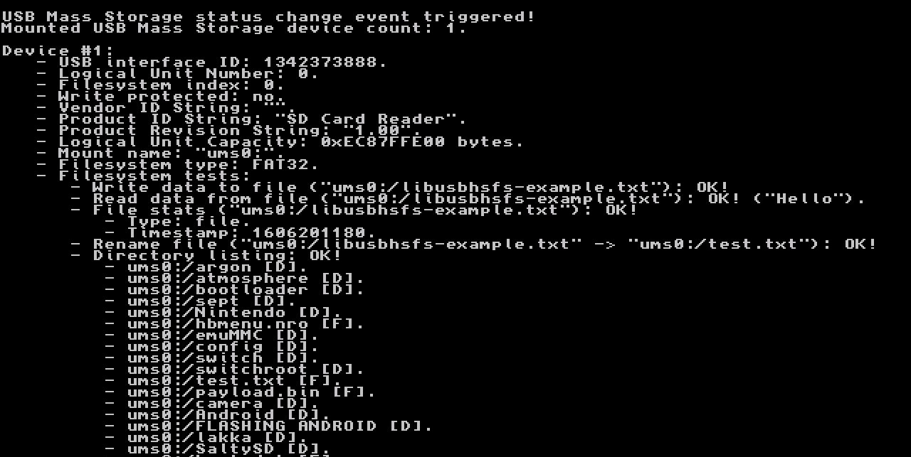

just try an example build, seems need to declare of usbHsFsInitialize()
well done, finally UMS come in
It actually means usbHsFsInitialize() ran, but couldn't finish all of its startup steps. 0x19C8C seems to be a USB error code.
Are you running any background sysmodules with USB access?
You can alternatively edit the Makefile from the example test app to link it against the debug version of the library (e.g. -lusbhsfsd instead of -lusbhsfs). That will generate a logfile in your SD card root directory with information about the function call that triggered the error code.
yeah i use ams_mitm.kip from xortroll over my hekate_ipl, so i think it ran background, ok i will edit my atmosphere configuration, also Makefile for logfile, thanks for advice and quick reply

ok seems listed everything on my card reader, also i do several test, i open on hbmenu i use full ram access mode
with usb 2.0 flashdrive on third time i launch .nro it wont listed anymore (no matter is exfat,fat32,ntfs,etc), idk maybe alot sysmodule i ran on my background procces
with usb 3.0 flashdrive is listed everytime (exfat)
with usb 3.0 external hdd is listed everytime (ntfs)
with usb 3.0 card read is listed everytime (fat32)
