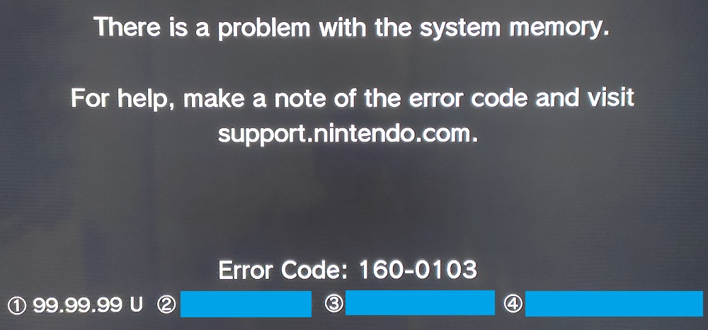

Hi all, I recently dusted off my modded WiiU after literal years and stupidly enabled a Wi-Fi connection without a DNS through settings. After playing for a couple days I realized the clock was incorrect, so I tried to open settings to change it and was greeted with the attached error screen (it said FW 5.5.3 the first time it appeared). After several reboots, both on clean mode and on Haxchi, with storage connected and disconnected, I got a message that a system update was ready, with no option to cancel, so I just went through with it, that's when the 99.99.99 string appeared.
Is there any fix so I can properly open settings again?
I still have access to homebrew and my games running from a hard drive
