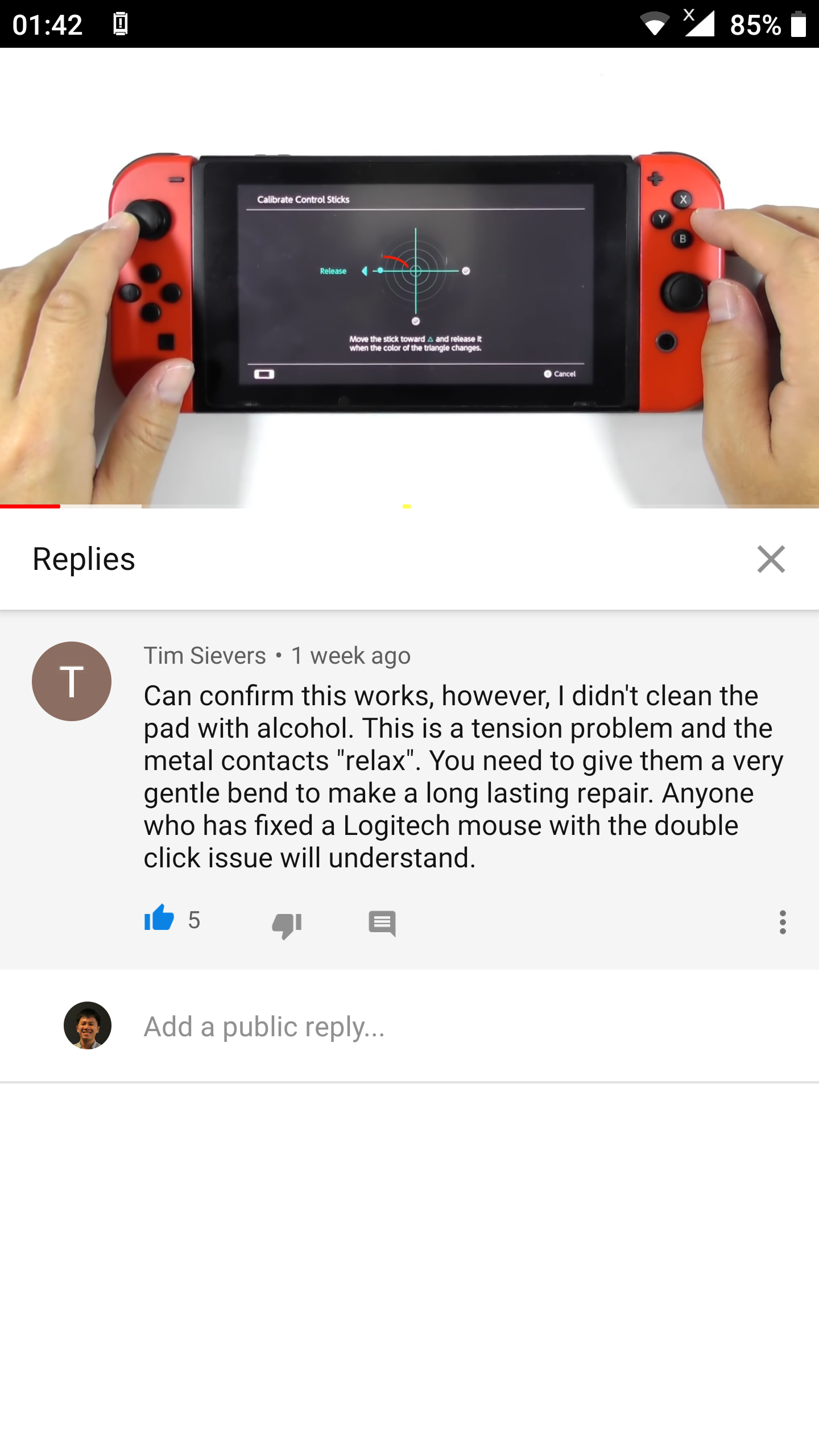

The inside of the analog itself is completely covered by the plastic cover beneath the stick thumb. There won't be any dust can cause the drifting issue. I opened 10 drifted analogs and didn't see a single dust inside.
Ended up the drifting issue causes by the metal contacts (4 of them) with the charcoal sensors are bended due to heavily drifting, so that they were loose the signal. If 99% alcohol (should drop inside of the plastic cover beneath the stick thumb), dust blowing or even after calibrating wouldn't fix the issue, tear apart the drifted analog then gently bend the metal contacts to fix the issue completely. Fixed all of my drifted ones using this idea.
