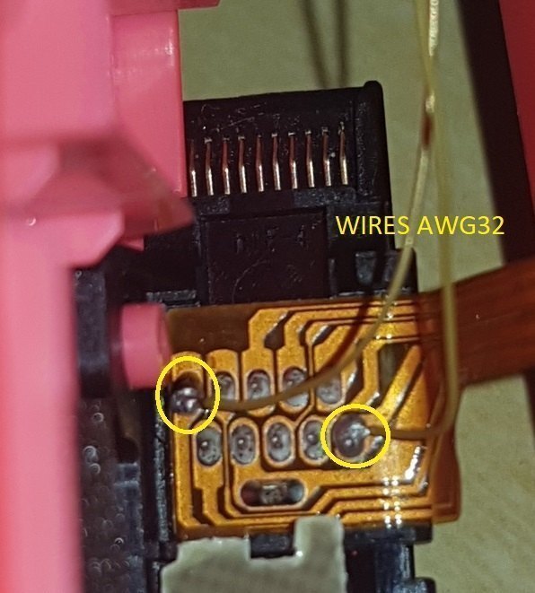

STEP 1: Turn the SMD TACT SWITCH button under the eject until!
STEP 2: SMD TACT SWITCH Welding on Pins 10 and 1
STEP 3: Be careful not to break the ends of the wires as they are fragile.
STEP 4: Pins 10 and 1
STEP 5: Do not pick up the soldering iron over the dots as this can damage the soldering point.
STEP 6: Insert SMD TACT SWITCH under the EJECT button until it snaps into place.

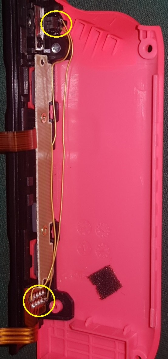

If it does not fit under the EJECT button, cut one of its edges to be perfect then
use SUPER GLUE Like SUPER BONDER or any glue based on "cyanoacrylate" to fix the button in place.
STEP 7: Positioning the SMD TACT SWITCH
STEP 8: Solder point on SMD TACT SWITCH
STEP 9: And this is the SMD TACT SWITCH 0.6mm twice as thin as a credit card.
And to use is it just press the sequence at all in same time for just 1 second when you Nintendo Switch is Powered Off.
"EJECT + VOLUME (+) + POWER BUTTON
AND SEE HOW IT WAS AT LAST, TOTALLY INVISIBLE.
