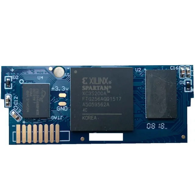

NEW-2018-EZ-Flash-Omega-flash-cart-with-direct-save-Support-max-128GB-Micro-SD-memory.jpg_640x640.jpg
This is supposedly the regular backside of the EZ Flash Omega-PCB.
Mine however looks like this:
Can this be an indicator probable poor quality of the flash card? Dunno which of these is these chips that uses PSRAM..
According to the docs it's the chip on the right. I don't think a little bit of smudging on the chips necessarily indicates it's bad. *shrug* I'm really not any sort of hardware expert, though.
