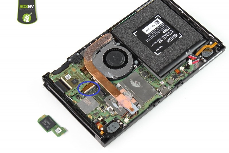

If reseating the ribbon cable doesn't solve it you might have to swap the motherboard onto another unit. The ribbon on the other end is directly connected to the LCD, while the other end is connected to the zif connector on the motherboard, I have one currently in similar situation where it is not showing the image correctly with lines on the screen, similar case to you.

Gotcha, think going at this myself might be a bit more then I can do. But may be worth something, checked serial and its a unpatchable unit.
The ribbon cable I circle is the one you should take a look at.
