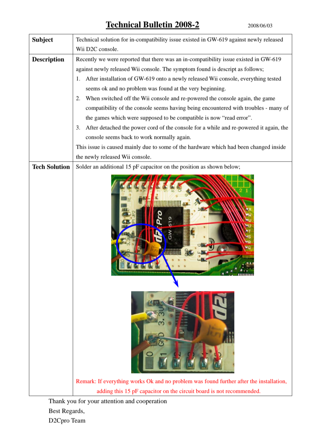

Hello, I don't know much about modchips but I saw you were trying to find a diagram for this one in an old thread, unfortunately even after visiting the link with the way back machine the images appear to be gone. After countless reverse image search I found a website that still hosts the image but it's corrupted:(, it shows the full image in the preview but when i open it half of it is missing, I'm leaving the link to the image in case anyone here knows how to recover it: https://www.chipi.ru/wii/pics_wii/d2cpro_diagram.jpg
Also, using the wayback machine i managed to get this info about the modchip but I don't know how much it will be of help, good luck.

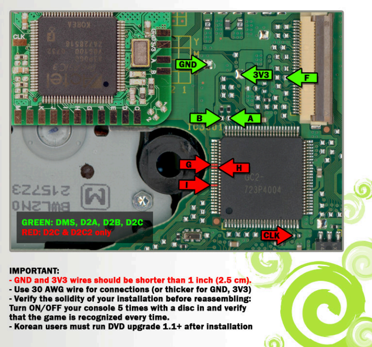

Thanks for the reply! Unfortunately that chip is the d2cPro GW-619, while mine is a d2ePro GW-609A. If you look at the pictures, it has waaay more cables than mine (d2ePro has 9 in total). I, however noticed that the chip has a very similar install layout to the Wasabi modchip:
I'm wondering if perhaps this would be the correct way to install the modchip...
