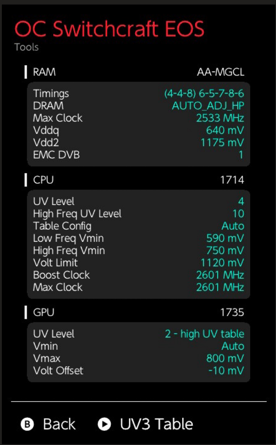

Is there a way to check these outside of Hekate, like with some other homebrew that runs in HOS? I have a modded OLED but the screen is busted so I can't use Hekate.
If you follow the guide here https://rentry.co/howtoget60fps and set up Ultrahand and Switchcraft (the undervolting utility), you can check your RAM type and CPU/GPU speedos in HOS. Once it's all set up, open Ultrahand by pressing ZL+ZR+dpad down, then press dpad right to access Switchcraft. Press d-pad right again to show new options, then select Info. You'll see an overview like the one in the picture, your RAM type and CPU/GPU speedos are shown in the top-right of each section in white. (It doesn't show SoC speedo for some reason, I think hekate's needed for that.)

thanks, I'll try it
