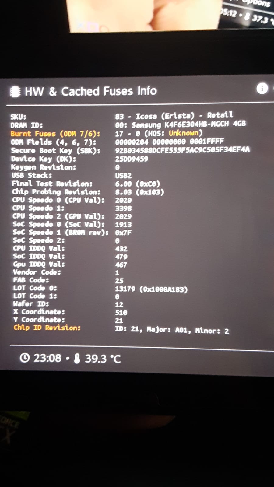

That's another problem, is there a way to know for sure which version I can downgrade to? I got this switch recently and I don't know if the previous owner burned the efuses
You can downgrade to any version but your game cart slot may not work due to mismatch firmware on the controller as far as OFW and Atmosphere is concerned. Don't know anything about SX
efuse can only stop you if you can't do RCM boot
Reactions: impeeza
Verifique el conteo de su fusible en hekate
Well I don't know how to interpret these data

EDIT: content deleted as irrelevant. You failed to mention model, but the screenshot clearly shows you have an Erista model. Your emummc would theoretically work, if you setup your card in a way that SX recognizes, and you use hekate/atmosphere to downgrade it first.
