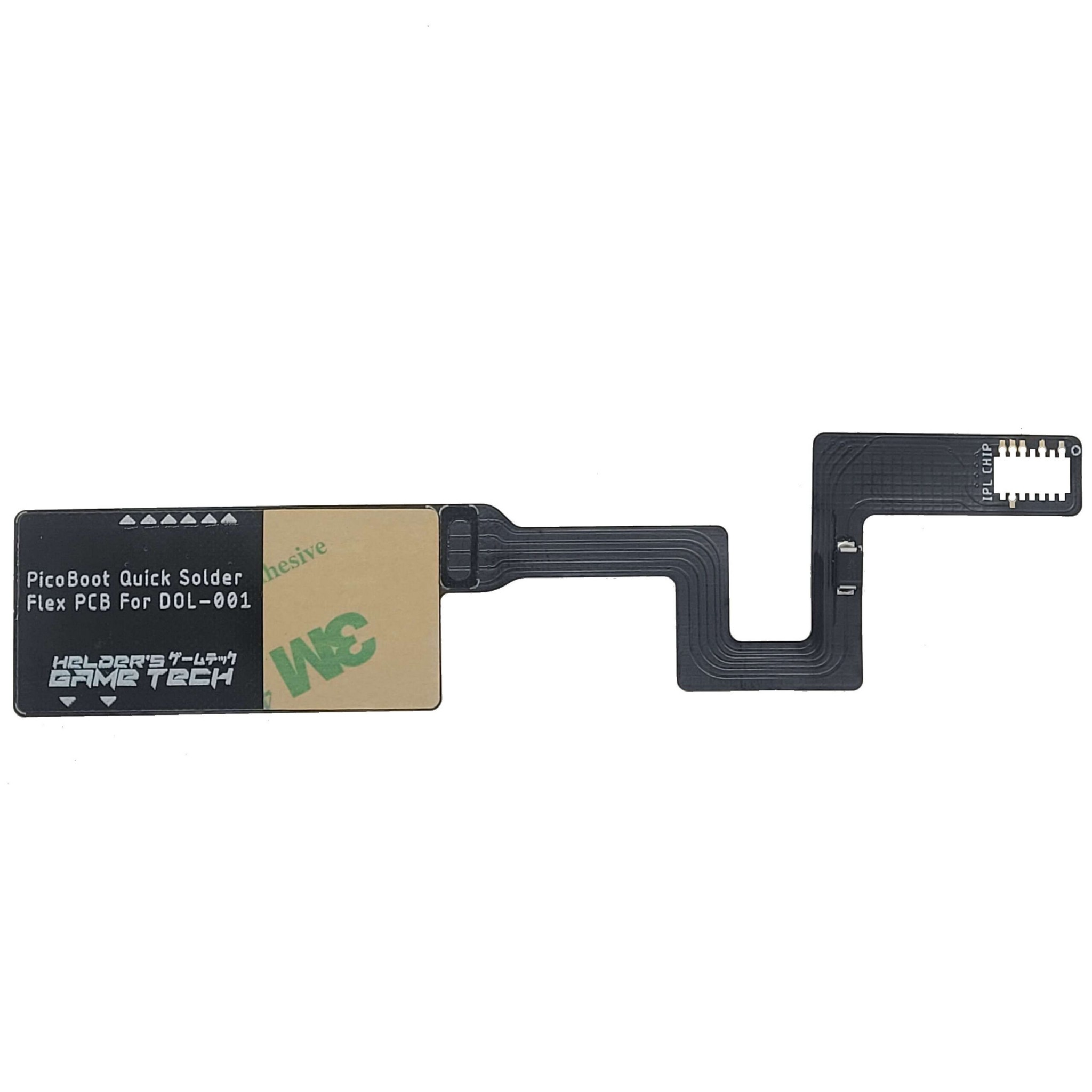

The PicoBoot is a great low cost option but does require some soldering. It's pretty easy soldering, but I wouldn't do it if you have zero soldering experience, ask someone with at least a little experience to do it for you instead.
You can get by with an exploitable game, or a Datel SD Media Launcher (or even an Action Replay if you buy a SD Gecko and type in the cheat code for SDLoad)
But all of those methods are kind of a hassle. To be able to have it autoboot into Swiss, you need a modchip.

https://heldergametech.com/shop/game-cube/picoboot-quick-solder-flex-for-dol-001/
